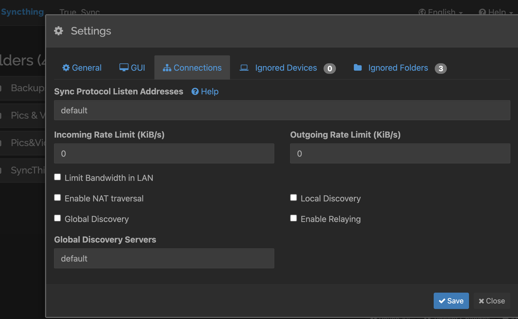

My brother and I have successfully connected our NAS’ together using Syncthing. I’m using a TrueNAS mini, and he’s using an old Dell enterprise server w/ Proxmox and ZFS pools. He’s on the East Cost, I’m on the West Coast (of the US). Using Tom’s various Syncthing videos, we’re using a “direct link,” by unchecking the various relay options in our settings, and forwarding Syncthing’s tcp port 22000.

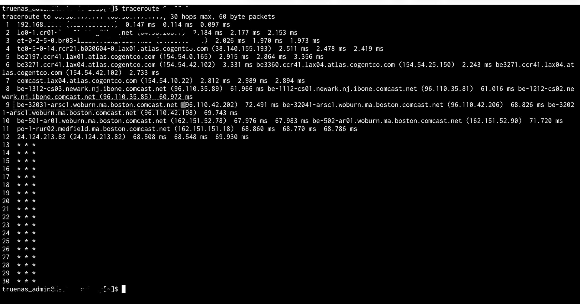

However, further tests, such as trying to ping each other’s public IPs and using traceroute have yielded some peculiar results, which lead us to think we may not be getting the speeds we should. Regarding pings, neither of us get a response. None. 100% packet loss. Running a regular traceroute on my end yields the following:

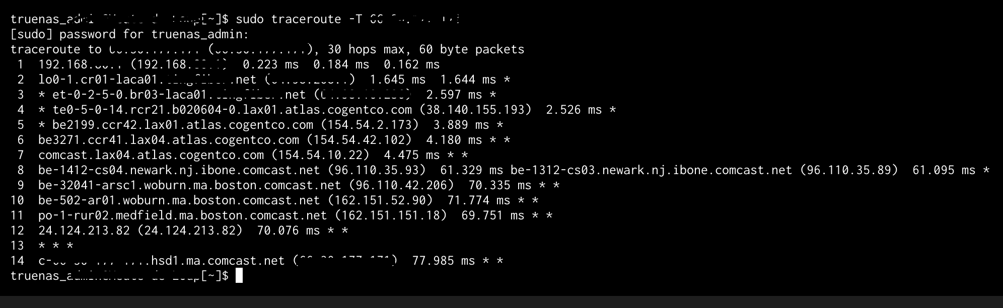

When I run a traceroute -T <Brother’s Public IP> though, I get the following result:
When my brother runs a traceroute, his path takes him through Sweden six times before ending up on the West Coast, but then, disappears into the abyss of, “***’s.” For what it’s worth, extending the traceroute to 100 hops doesn’t yield an end either. My brother does web design and programming, so not an expert in networking. I’m not in IT, and only know what I’ve read and seen online in various YouTube videos. We were going to begin utilizing other troubleshooting methods, but kids and other familial duties keep getting in the way. Hence, why I figured it’s time to reach out and ask for your insight and assistance.
