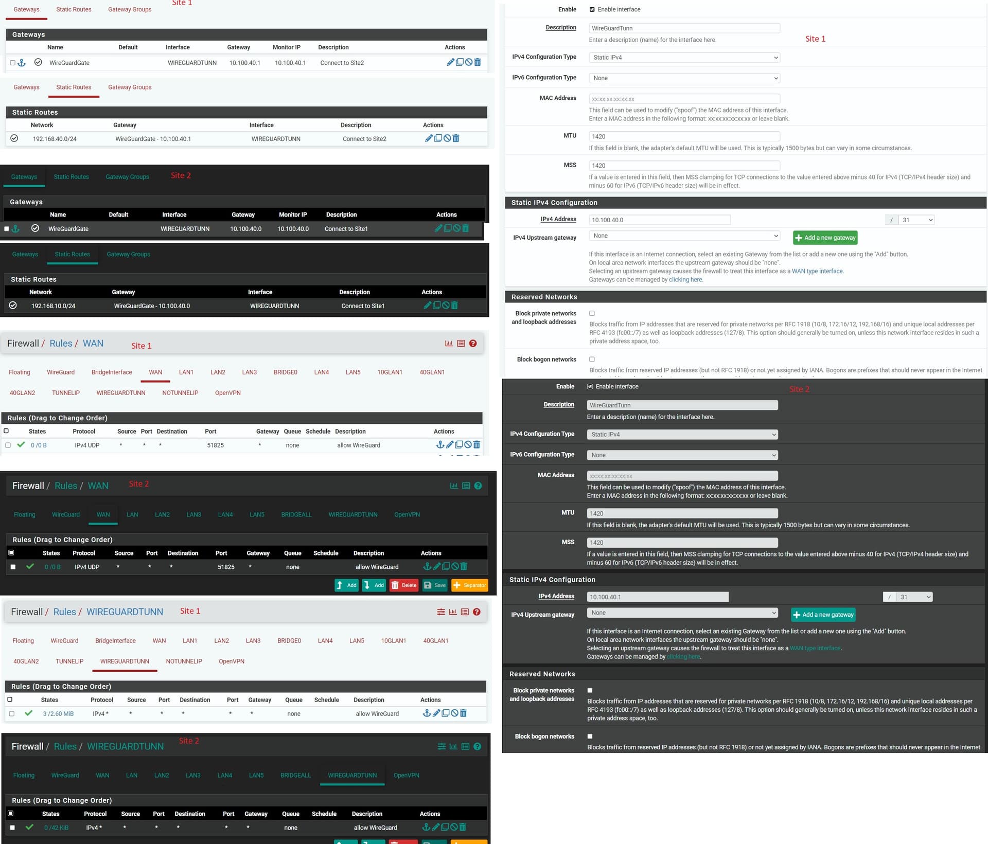

see attached photo. Had it really nice and clear but apparently new users can only upload 1 pic so it is all merged. Let me know if this is enough I would really like to get this to work. Site 2 is fresh install only plugged in for 5 days. Site 1 is 2+ years old and a ton of settings.
Apologies for getting back later than anticipated. It took a while to look over the information. I need just a little more information to help guide you to your issue. Based on your first post you mentioned the IP address range for Site 1 and Site 2.
Can you confirm that
Site 1 LAN is: 192.168.40.0/24
Site 2 LAN is: 192.168.10.0/24
Also, please confirm for the tunnel which site is which. I am assuming that the dark theme is Site 2 but I would like to be sure rather than just assuming.
Tunnel Site 1: 10.100.40.0
Tunnel Site 2: 10.100.40.1
I have gone through the information/picture you have provided. And can tell you it’s not a firewall issue. I have narrowed down the possible cause but please confirm the above questions. This way I can confirm I’m not providing you with the wrong guidance.
