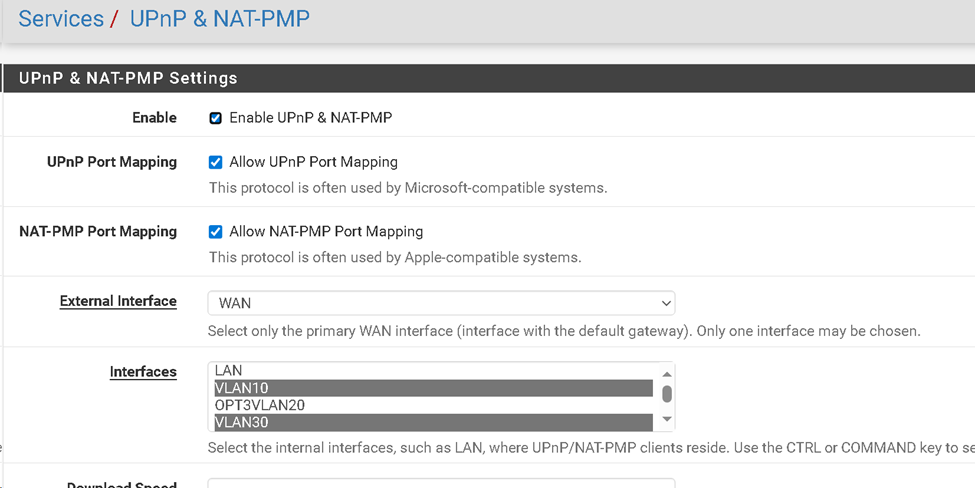

I’m trying to run programs for crypto that specifically require UPnP to be active.
I’m currently running pfsense v 23.09.1.
I have my regular LAN set for 192.168.2.0/24 for my desktops.
I have several Vlans and all are isolated by firewall rules so they can’t communicate to each other.

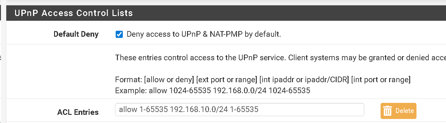

I setup a separate Vlan 192.168.10.0/24 called Vlan10 for these crypto programs.

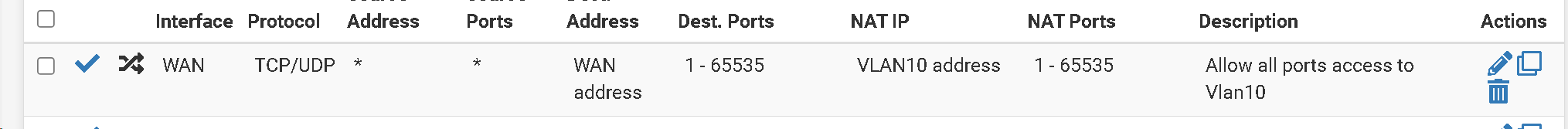

The program requires the ability to be connected by random ports from outside the network at various times, thus the need for UPnP.

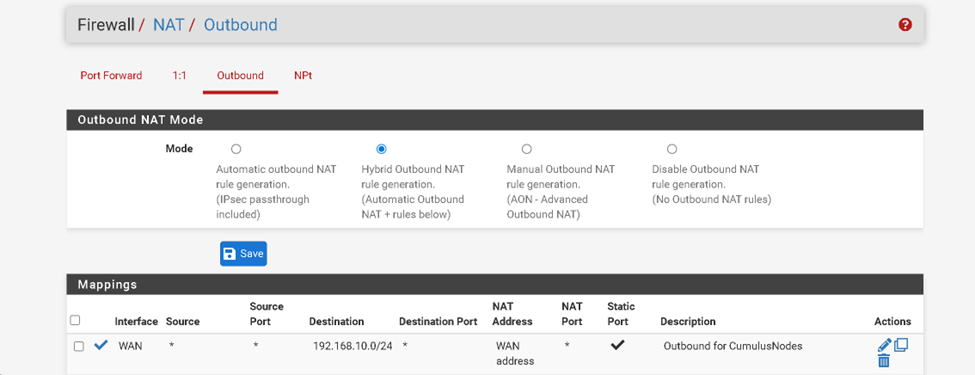

I was instructed to setup the outbound nat this way as well.
I am still getting errors with the program complaining ports are not reachable from outside.
