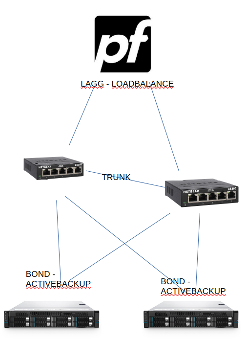

Okay, I’m at work and haven’t been able to try this out on my own otherwise I would just do it and see it it would work, but I want to make a LAGG interface on my pfsense in loadbalance mode and connect each of the physical ports on the LAGG to each of my two rack switches, then my two servers (one running TrueNAS Scale, one running unRaid) will connect to both the switches in a bonded network interface in active backup mode, would this be a viable not actually high availability/redundant setup that would be able to sustain a switch failure? Or would bridging the ports on the firewall be better? or should I just give up because it’s just not really ideal?
Both switches support full lacp and stp.
(Images are just placeholders)
