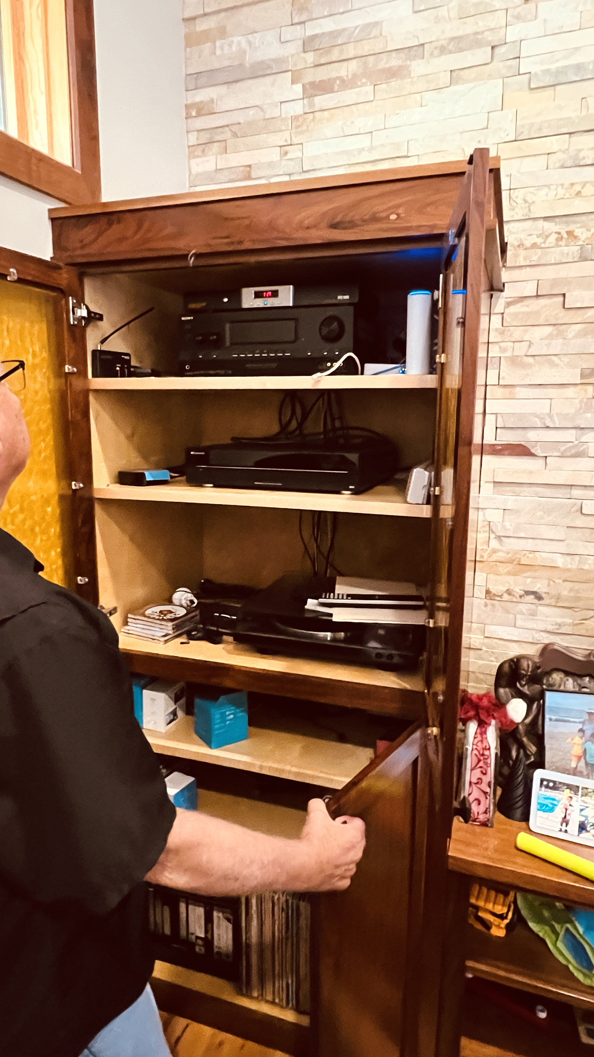

He has the following equipment:
Russound MCA-88 - connected to several in-wall speakers and zones already mapped within the settings.
Sony Multi-Channel AV Receiver STR-DH8DO or OO - this is connected to his TV via HDMI and RCA output to the Russound

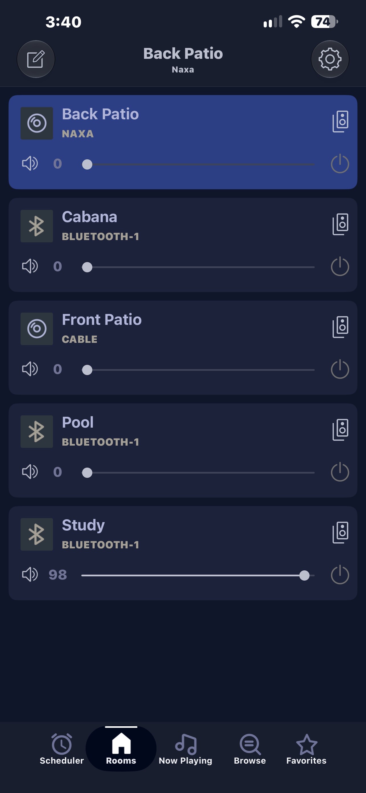

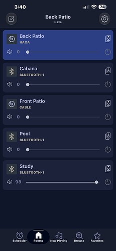

The issue I am having is with the Russound. I have the app downloaded on my phone and I see several zones. But I cannot get audio to play out of the speakers connected to any zones 1-4 which I have the speakers connected to.

Adding screenshots of the app and the zones that are set up
