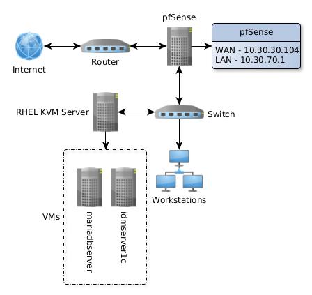

What may have caused this and how to correct it? I’m using pfSense for my DHCP, DNS Resovler as the Forwarder from the IDM Server, and NTP for the IDM Domain clock sync.
Network Topology.
