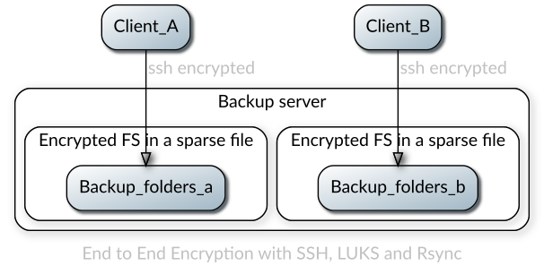

You could always Rsync to a LUKS encrypted volume
