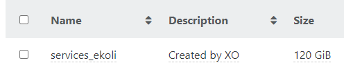

Resized disk in XoA but not seeing it in the VM
Using XenOrchestra I increase the size of my VM disk from 48GB to 120GB
However when I run lvdisplay, I still see only 48GB so cannot extend it.

Looking at the disks under Local Storage, and it all looks fine there too
