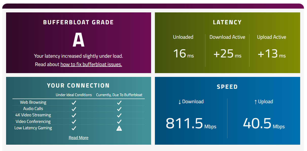

After running the buffer bloat test, I was getting an Grade A in bufferbloat but explained that ‘Your latency increased slightly under load’ for low latency gaming.

After applying, bufferbloat test results is still A ‘Your latency increased slightly under load.’

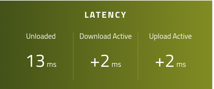

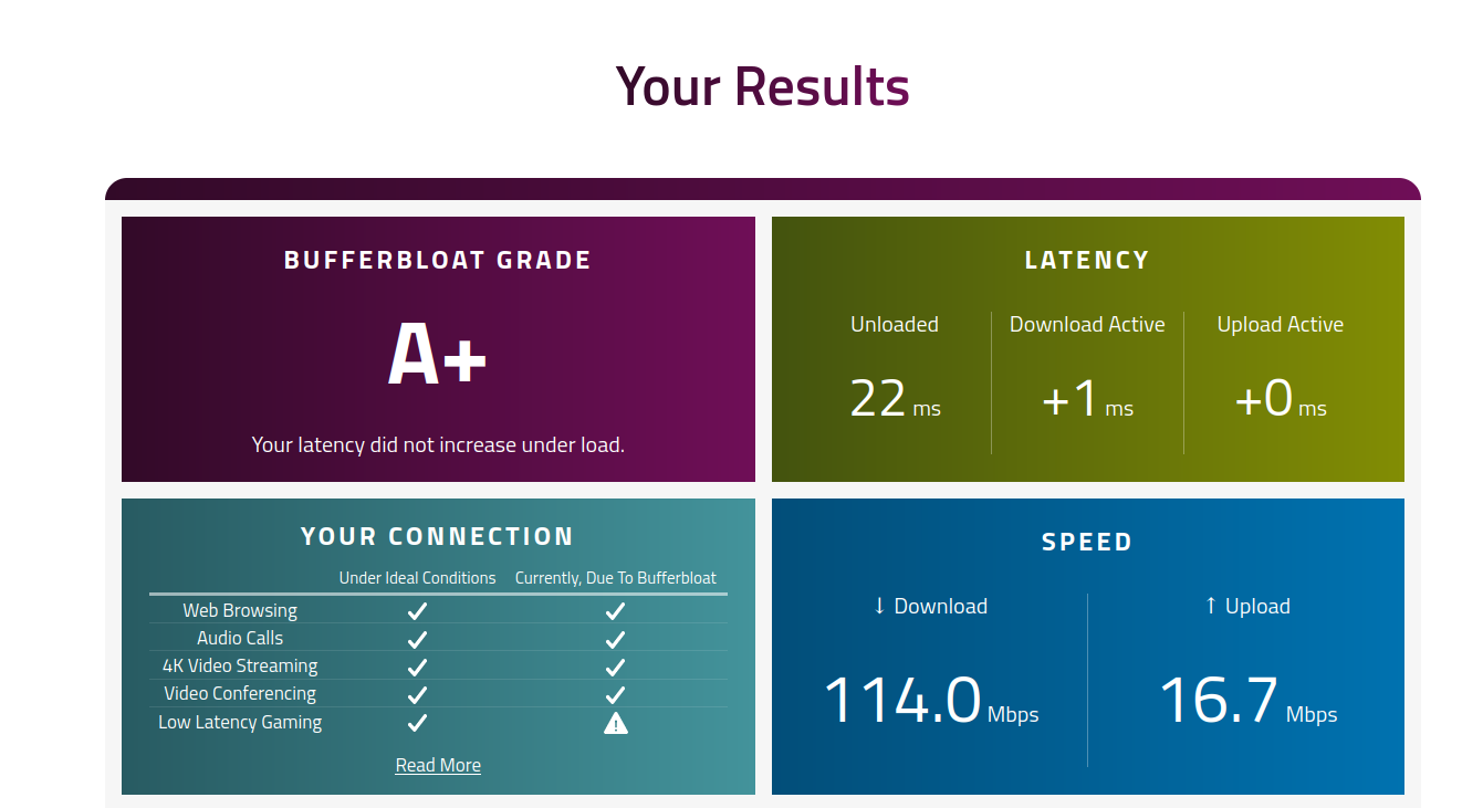

I’ve applied some shaping on my vlans, I get a A+ :grinning:
Though I don’t game, before traffic shaping browsing on the internet wasn’t as good, after some sites were a bit more snappy!
