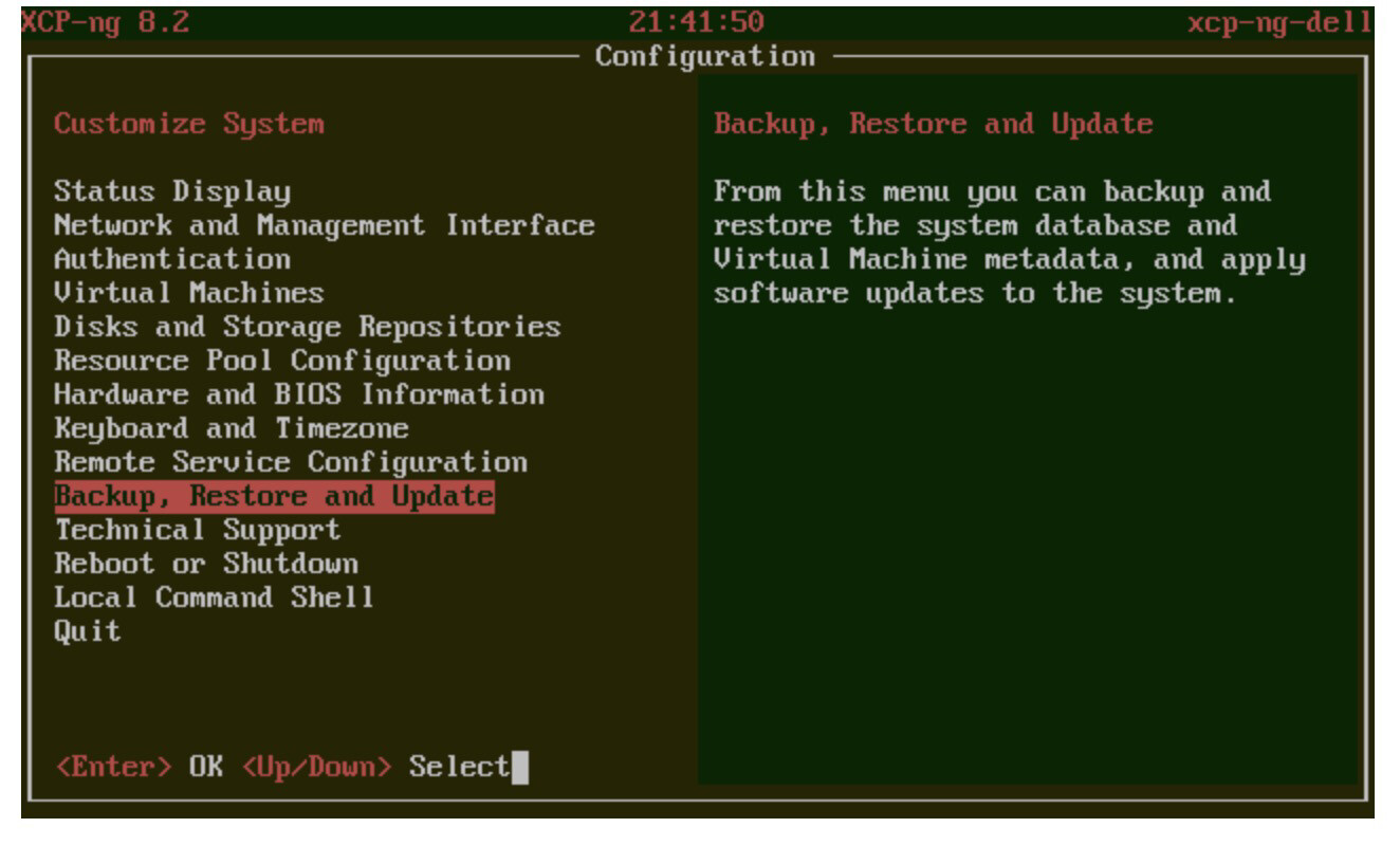

I’m new to the forums and XCP-NG and have a similar issue to OP. The ssd in my Host is failing and I’ll be wanting to install a replacement.
I have two VMs that are located on my NAS via NFS (with backups) , so I’m assuming the SSD only has the files needed by XCP-NG? If i do a metadata backup from the host configuration menu (to the NAS) before replacing the SSD, will I be able to simply restore the metadata backup (after creating the NFS to get things working again?
Yes that should work, the only challenge with restoring is the local mounts storage mounts will be different. I would still make sure you have a proper backup of the VM’s as well.
Just an FYI for everyone attempting the same, restoring metadata must be done to the same version.
E.g. if the metadata backup is from 8.2.1, you must restore to a 8.2.1 install.
8.2.1 metadata won’t work on a 8.3 install.
