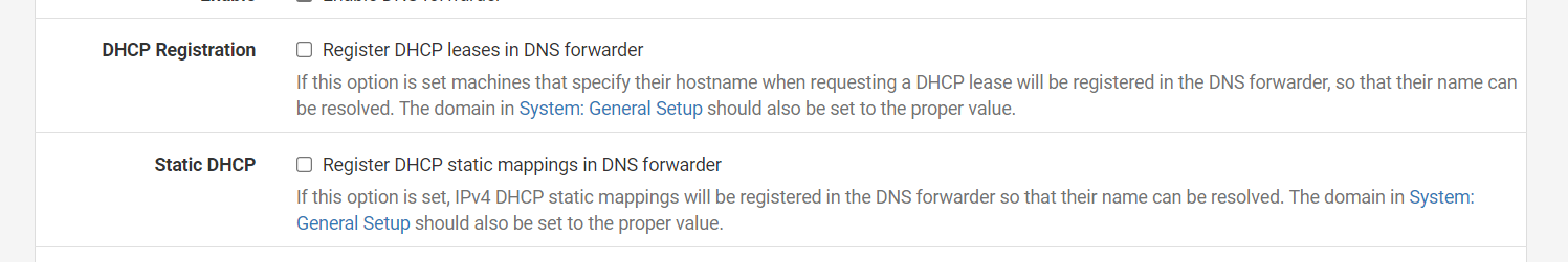

I’ve successfully migrated from piHole to pfBlockerNG, so the client devices use the domain controllers as their DNS servers, which then forward requests to the firewall. However, I am not getting any logging or reporting through the pfBlockerNG panel, even though I have confirmed that it’s working. A while ago there were issues with reporting, but based on what I have seen the bug was resolved. Anyone have suggestions on fixing reporting? I haven’t touched DHCP assignment yet, and I think I would rather work on Haproxy first after this is done.
Would these two options allow pfSense to handle DHCP assignment while passing along that information to the domain controllers? UCS is good at a lot of things, but DHCP is surprisingly primitive so it would be nice to hand this back to the firewall if I could make sure those addresses are known to the domain controllers.

Could you get UCS to just forward DHCP to pfSense?
I never ended up implementing the changes. I haven’t had as much time to tinker lately, and so as long as it works I am sort of in a holding pattern. I will probably look into making deeper changes over the Christmas Break when I have more time.
Well, as long as you don’t install the DHCP server from the App Center, you should be fine doing DHCP on the Pfsense.
