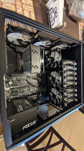

Also keep in mind you don’t need to just use the “built” in spots in the case for fans. You can always get creative and mount extras in there. I know in my NAS I wanted extra fans to help pull air through the HDDs and it also moves air across other things, so I mounted fans to the outside of the HDD cages:
https://www.cdmfabrication.com/bbpics2/os/truenas9.jpg
