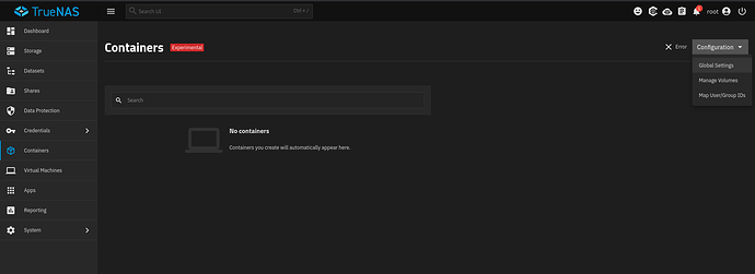

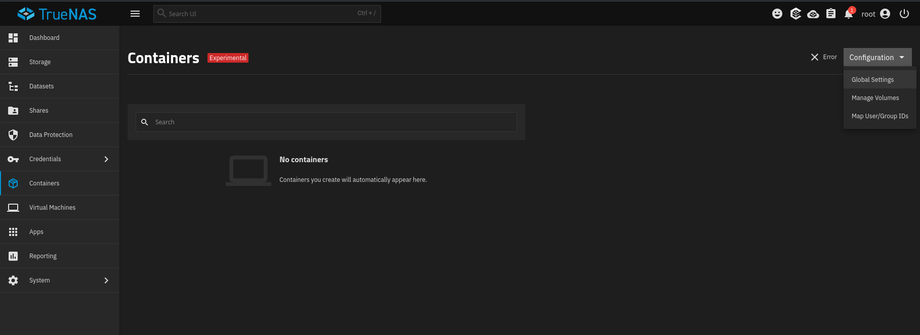

Well that’s odd. I updated from 25.2.1 to 25.3.1 the other day, and now my container is just gone. I took a backup before upgrading, but I’m wondering if upgrading to the new version where containers aren’t experimental would be better. Though, I can’t make another one now. I did a little searching but didn’t find anyone else with the issue, especially since no one’s said anything here. What to do..
I move a few systems to version 26 beta1 and the containers for PBS are still working, check the TrueNAS forums to see if there is a bug.
