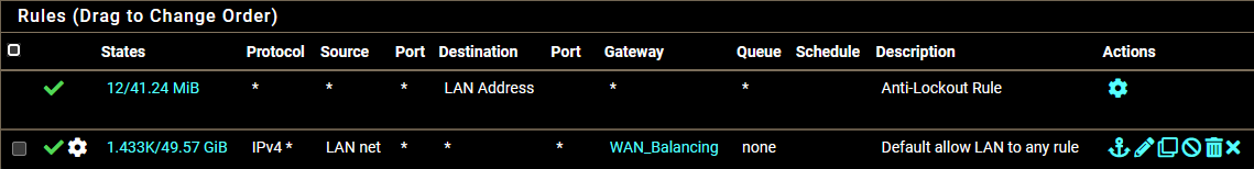

these are the rules I have, do I need additional rules?

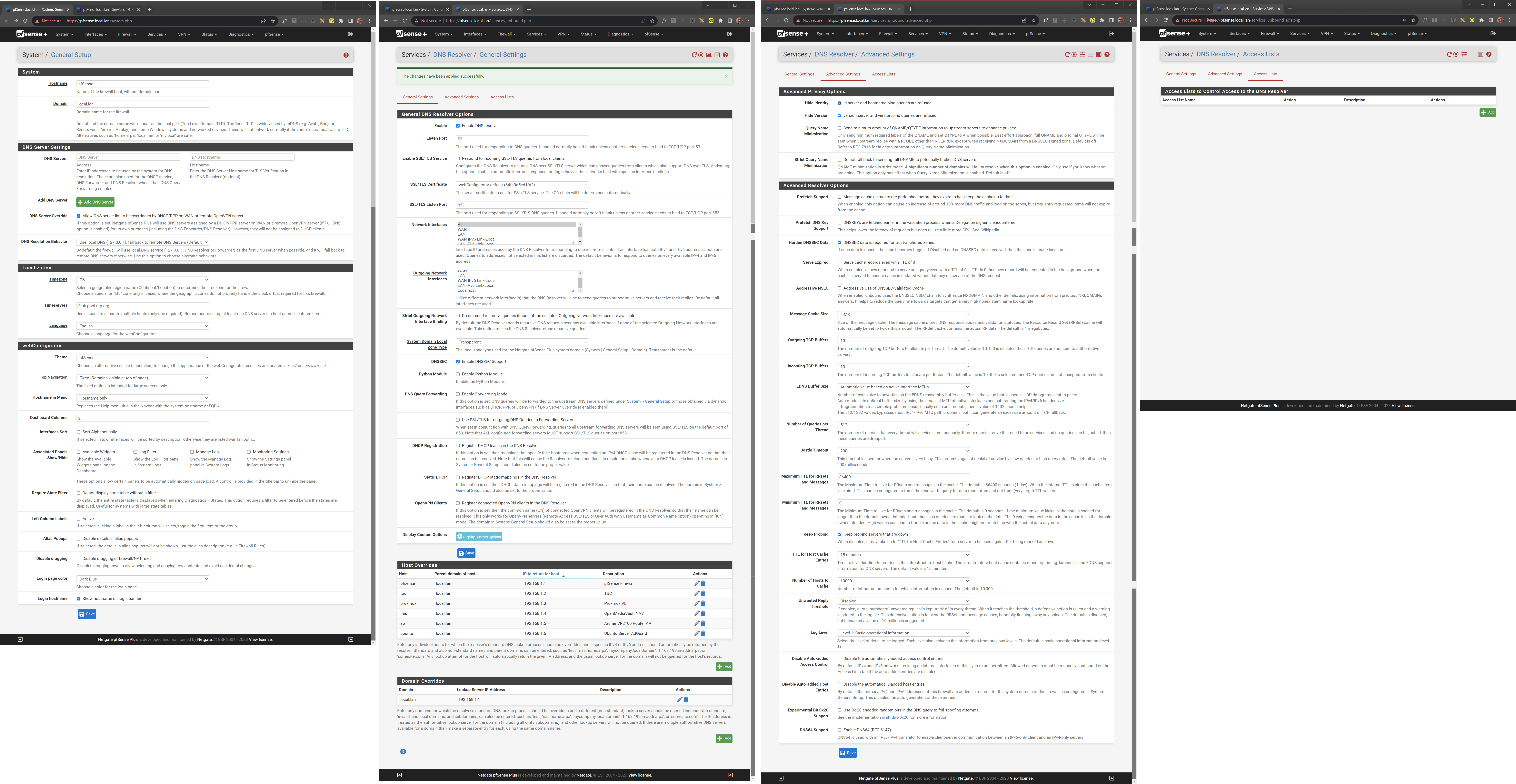

I have attached my DNS Resolver settings below for comparison. Note: all Advanced settings are defaults.
*Note: Windows nslookup only considers it a FQDN if it has a trailing dot e.g. microsoft.com <> FQDN
microsoft.com. = FQDN
If you do not include the trailing dot, nslookup by default will append your local domain (and potentially any connection-specific sub-domain) to the query.
