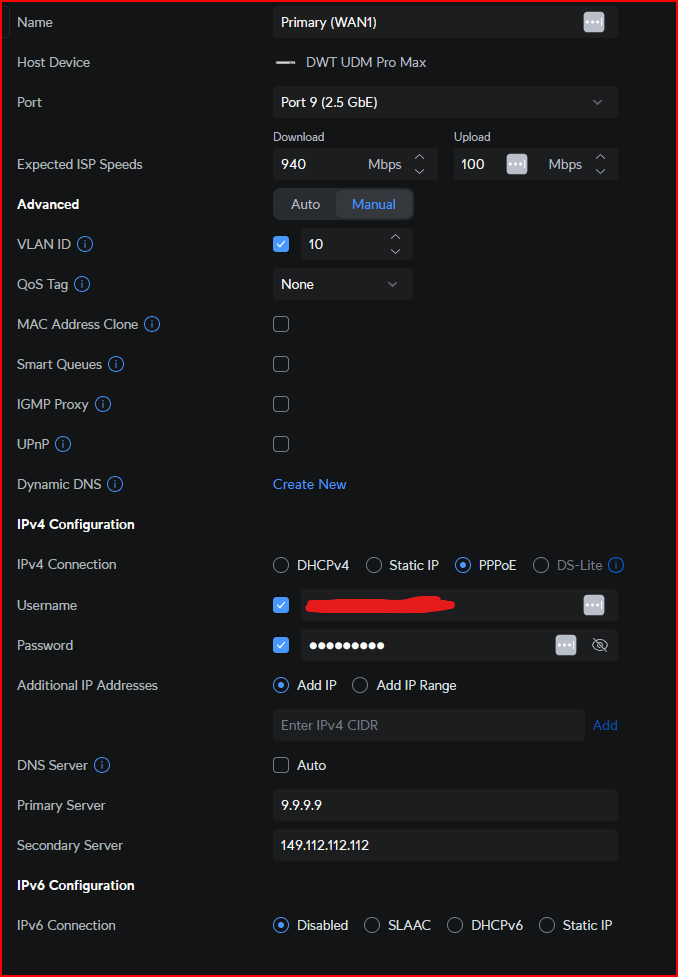

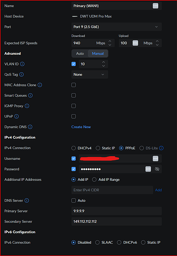

Hey there.
I have a PPPoE Gigabit connection from my provider.
I have a UDM Pro Max.
I have the fibre cable terminating near my comms cabinet with a small fibre loop going into the ONT / GPON. From there, it’s ethernet directly to the UDM Pro Max.
I had to set up the VLAN to be 10 in my case, and provide the generic username and password for the provider, just like the CPE router would be working.
I get 940 Mbps down which is about max really for PPPoE, and 100 up as that’s it’s limited to by the ISP.

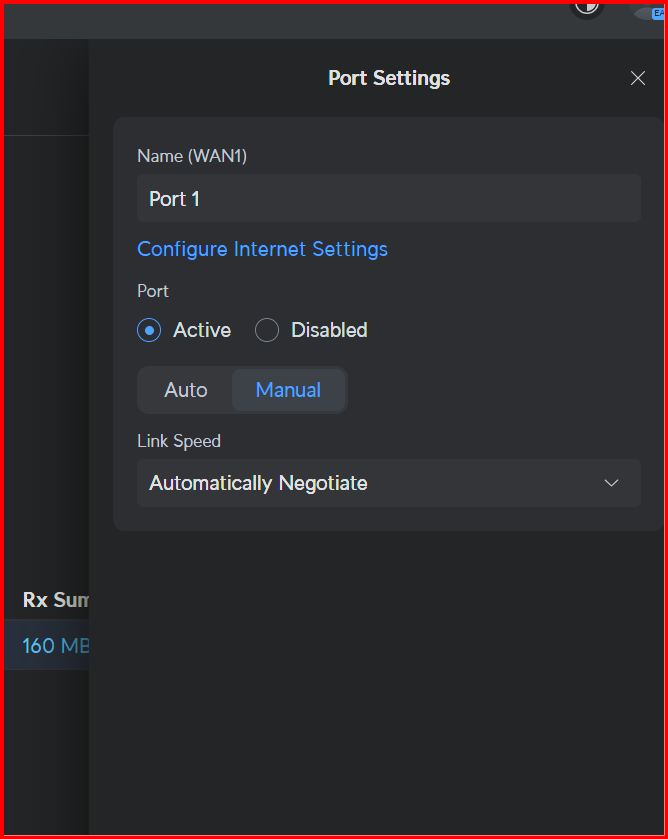

try setting the port speed manually 1Gbit if possible.

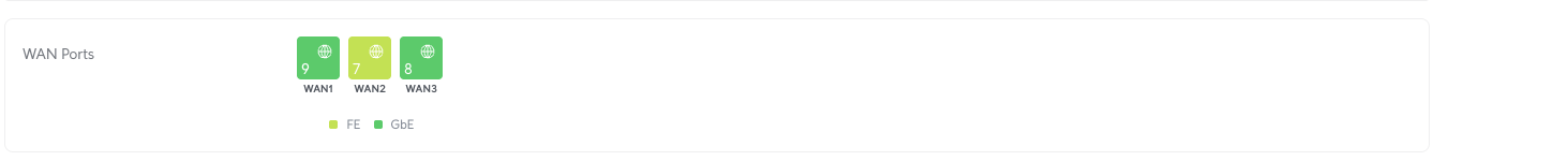

Then, maybe it’s something on the ISP’s side. I’ll need to investigate further. The cable could be an issue, so I’ll definitely check that. What my UDM-PRO is negotiating is gigabit, but it might be because there’s a media converter on my side. It’s possible there’s something on their side that’s limited to 100 Mbps.
Image attached : WAN 1 is what I am talking about here
try switching mannually the WAN1 port speed to 1G FDX ( make sure you log in from the inside of your network not from cloud, so you dont lock yourlelf out. )
you will know imediately that it works or not.
