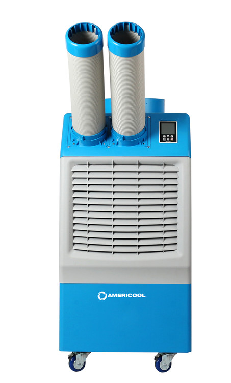

What do you think about one of these?

I’d contact Americool and ask them what they suggest. That’s a lot of money for something that may or may not work. Again, there is a lot of heat inside the cooling unit, and if that unit is located in the same room you are trying to cool, then you have effectively de-rated the device. Any good seller will have both the number for cold air out, and the effective number when the device is in the same room as the cooling. I would guess that the effective value for the 13,200 unit would be 9,500 to 11,000 BTU. Or it is really a 15,000 BTU device, and the 13,200 is the effective BTU after you throw away compressor heat and some heat soak through the cabinet.

Sorry to bring back this old thread but I’ve been trying to research these Americool products but haven’t found much info. Specifically the rack mountable WMC-2500. My cooling options are severely limited but I can vent exhaust into the ceiling and outside.
Did you end up going with either of these Americool products? If so, how was your experience?
