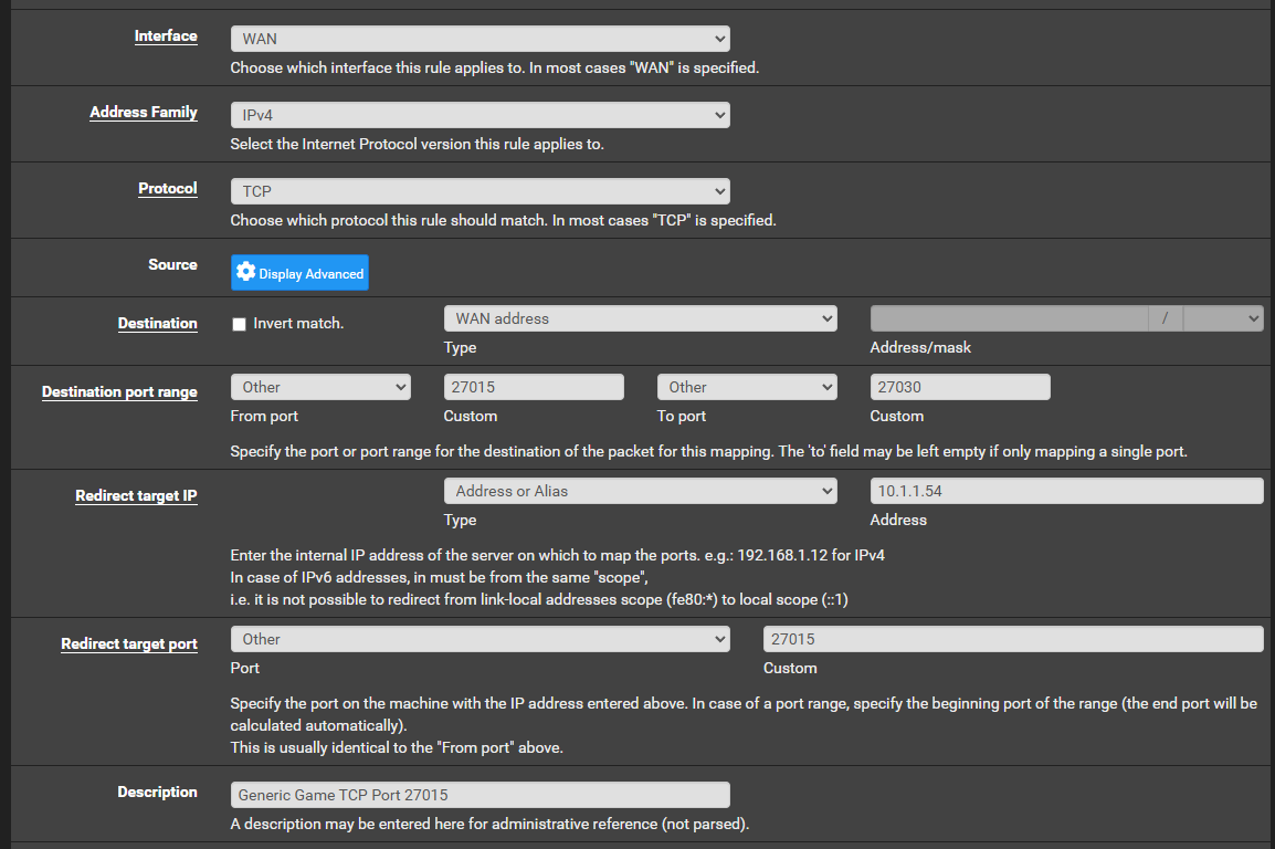

For instance, I have some game servers using port 27015, but is acting as if that port is still closed.
I tried changing the interface from WAN to my CARP IP, but that didn’t help. I keep reading that I need to set it to my “VIP”, but I do not understand what this is.
These are all very simple port forwards, below is the one example I mentioned above. Running pfSense 2.7.2 currently.

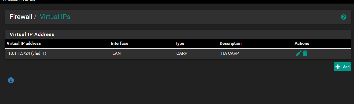

If you have an HA setup then you must have a VIP setup as well for your WAN addresses. To find out what it is you can find it under firewall>Virtual IPs. Find the one with the interface is WAN. Once you figure out what the VIP is then set that under your “Destination” in your port forward rule.

Not sure how I’d configure my WAN into a “VIP”. The pfSense book only details setting up LAN.
