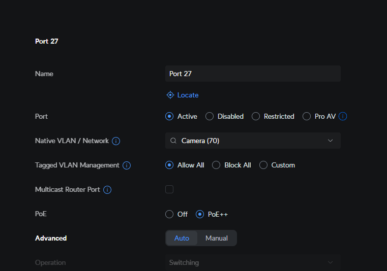

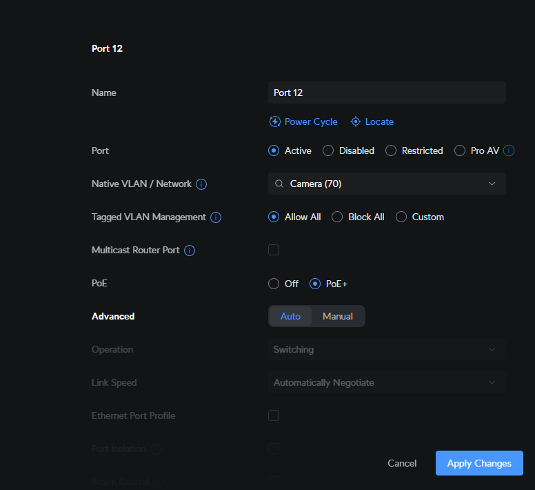

The other day I was trying plug a G3 Bullet to port 27 and I could not get it to work. After 4 trips up a 14’ ladder checking the wiring, I plugged the camera into a random port, port 12 and it worked.
I see that port 12 is lightning bolt-dot (PoE +) and port is lighting bolt-dot dot (Poe++). I always assumed the camera auto negotiate what it needed.
here are the setting on port 27, I see that PoE is PoE++
here are the setting on port 12, I see that PoE is PoE+

Yes it should negotiate properly in either case. PoE++ includes backwards compatibility with PoE and PoE+.
What is the exact problem that you experience? The camera is not turning on at all?

@hunor The camera just doesn’t turn on at all.
Blockquote
I have the same switch and my G3 Flex just dropped out from Protect. I had to remove, reset, and readopt to show up.
This is how this started … The camera just stopped working one day. I took it down and reset it and it started working again. But once I went back up the latter and hooked everything back up, switch , patch panel , to camera it didn’t work.
@brwainer That camera just doesn’t want work on any of the PoE ++ ports. Because I was just looking I have another G3 running on port 25 that is a ++ port.
