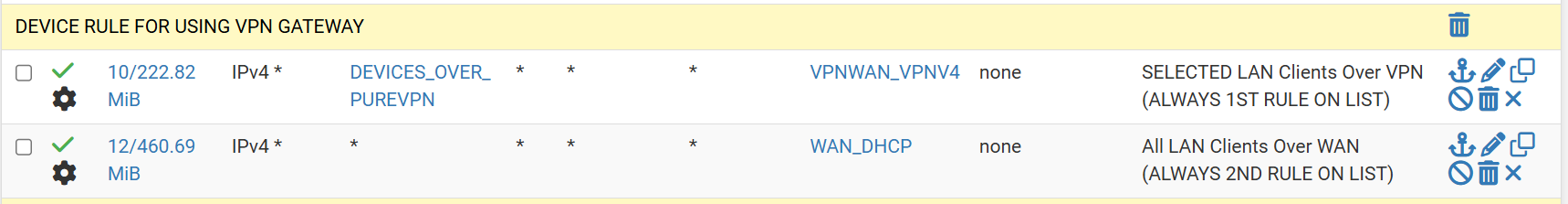

I have two gateways, one VPN (OpenVPN) and the other my standard WAN. I have firewall rules the routes traffic from select devices through the VPN or WAN gateway as needed. Rules as below

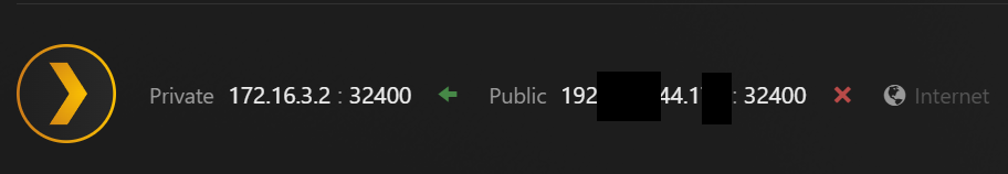

While this did fix my traffic routing so that my firewall rules were adhered to, since doing this, I cannot get access to plex outside of my network through the VPN WAN. See below plex, not happy lol
Please note that all my port forwarding is setup and correct as this was working just fine until the recent changes, so it is not related to my ports and I also double checked by running Plex through my WAN gateway, all works fine. So it is definitely something to do with the VPN routing.

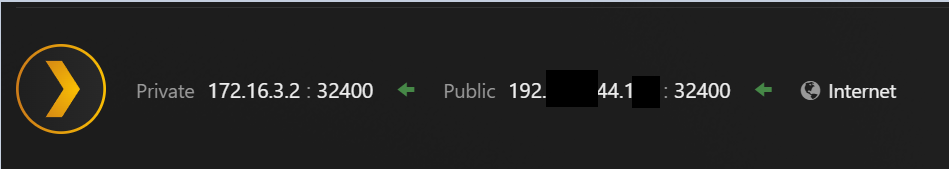

This again corrects the issue and stops the VPN from forcing itself as the default gateway in the routing table. However, while Plex now connects to the internet over VPN as it should (based on my firewall rules), when I try to access it from outside the network, I cannot get a connection to the server. Below shows plex getting out to the internet now.
