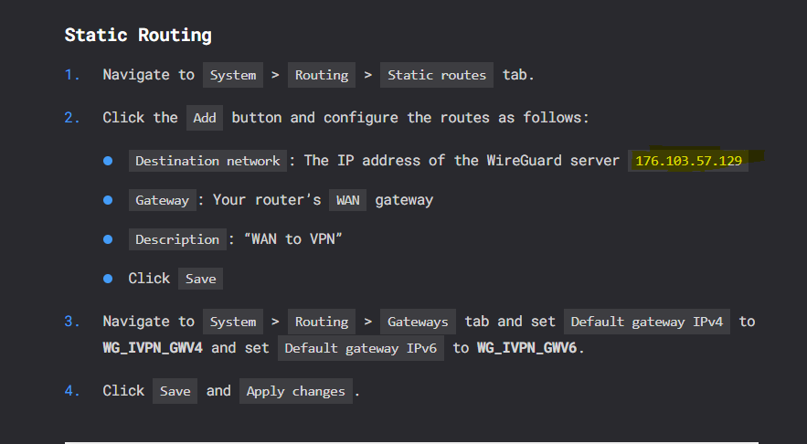

I have followed this guide to the religiously over 5-6 times and I keep getting the same results:

This is on a bare pfSense install, here are some screenshots of my configuration:

But I must admit… there was a portion on that guide that I totally did not follow.
This portion I was to put the IP of the VPN that I was connecting to, however, I was adding the 176.103.57.129 as shown in the instructions.
Adding the server IP I was connecting to made the network come up and stay up even after a reboot.
