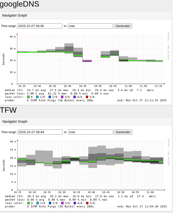

I know this is old, but still the case that pfSense only gives us a single gateway monitoring IP-address per gateway. False gateway down events still occur. I’m using 8.8.8.8. Problem I’ve had with using next-hop (beyond your static GW) is it’s even more likely than googleDNS to stop responding to ping (at ISP’s whim). Even less reliable if your WAN is not a static IP. I also have a smokeping instance running which is set to ping five different Internet IPs, including google DNS. While smokeping interval is much longer (100 seconds), it did confirm the packet-loss to googleDNS, while pings to an other host only experienced a small latency spike. During this event, I was at my desk working and didn’t notice any outage other than the email notification from my pfSense announcing the packet-loss.
