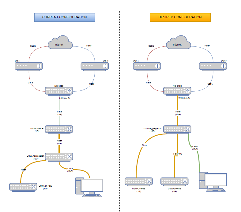

I have connected the NG-6100 to my network using the port labeled “LAN (igc0)” a cat 6 connection. I want to replace that connection with a fiber connection using an SPF+ (INTEL FTLX8571D3BCV-IT 10GB based on your documentation) to a Unifi Aggregation 10GB Switch, I want to have the Aggregation Switch to be the MAIN Switch. I don’t grasp the configuration. (See Attached Network Diagram)
Current Connections:
LAN (Cat 6), WAN1 (Cat 6), WAN2 (Cat 6) + 9 VLANs
I would like to replace the LAN Copper connection with FIBER OPTIC.
I do not want to configure the router from scratch if I do not have to,
If I configure the WAN3 (ix0) port to work as a secondary LAN network on a different subnet, configure some basic firewall rules to access the VLANS and WAN Access, Then disconnect the LAN cable and reconfigure the IP Address to match the old LAN subnet address, will that work?

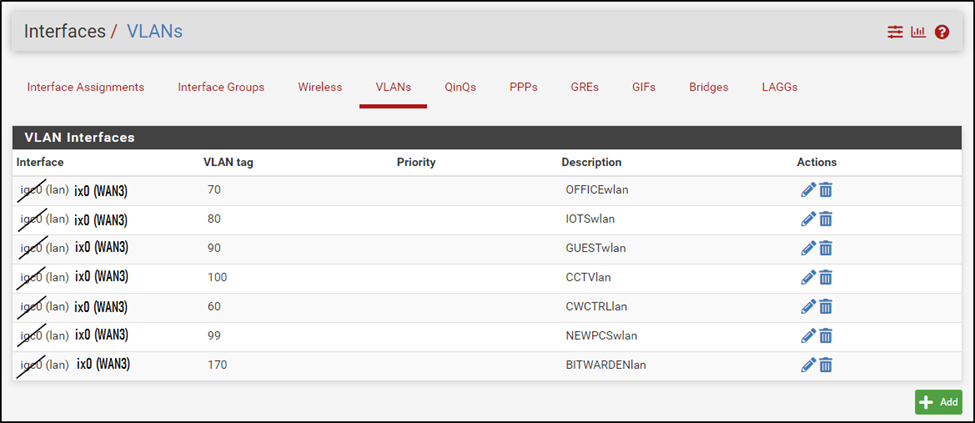

I configured the WAN3 (ix0) port to work as a secondary LAN network on a different subnet, configured DHCP & some basic firewall rules to access the VLANS and WAN Access, and changed the VLAN’s interfaces to use the ix0 interface because they were using icg0.
Restarted the firewall, disconnected the LAN cable, and reconfigured the IP Address to match the old LAN subnet address. Connected to the Firewall Web Configuration and changed the IP address for the icg0 interface to a different segment to free up the network subnet IP address to give it to the ix0 interface. Rebooted, assigned the interface ix0 with the original icg0’s IP Address, configured DHCP rebooted, and I lost access to the firewall, restored backup from the Console.

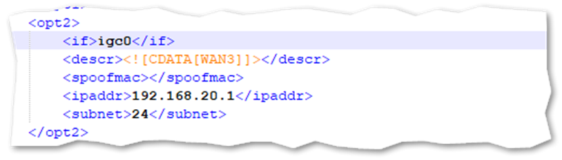

Downloaded an interface backup and changed in the .XML file the name of the interfaces there:
From this code:
To this code:
Uploaded the .XML file with the changes to the firewall, rebooted it, and disconnected the LAN cable. I connected to the Firewall Web Page, I made the changes to the VLAN’s Interfaces to point from icg0 to ix0 and rebooted the firewall once again. I could log in to the firewall web portal and had internet access. However, none of my VLANS were working.

I’m a bit confused on your scenario 2. The from code has both igc0 and ix0 with the same network address. They should be different.
