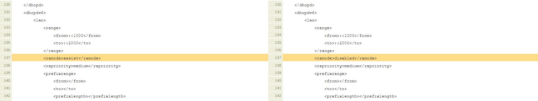

When I delete all the unnecessary stuff and finally run the PPOE setup wizard again, it fails?
So I made a backup before and after running the wizard and found that there is a difference in one line.
0
pppoe
pppoe0
re0
xxxx@xxxx.xx
--------ZH-----ub------=
yyyy
--------dH-----1b------=
on
Where “y” and “on” and the visible letters between the “-” are different.
Does this ring a bell or is it just a coincidence?
