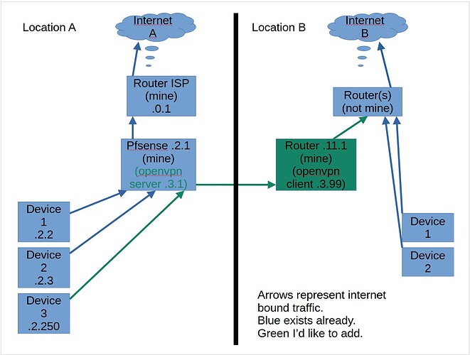

I’ve got 2 locations…A (my house) and B.
I would like select devices on my network A to access the internet via location B.
Solution – setup an OpenVPN server at location B, and my house A would be the client.
This would require port forwarding at location B…which is a no-go…no access to B’s router(s) config.
So…I’d like to set it up with location A being the server, and B the client. There are tons of guides online – I followed them – it works! Well…the OpenVPN connection works.
I cannot find any guides for what to click in pfsense to get select devices on A’s pfsense LAN to send their internet bound traffic to location B’s internet? Picture attached.

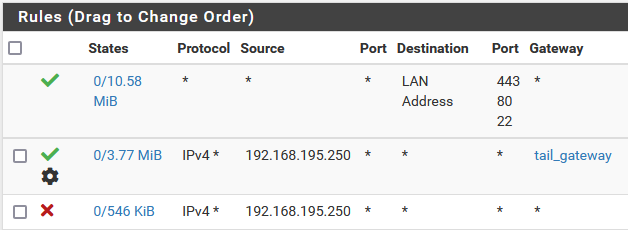

If I stop tailscale (on pfsense or the windows box), then I can reach the internet via the local WAN…which is weird…I have a rule blocking that. (see pic of top LAN firewall rules…sorry….195.x is my LAN…the original diagram I posted I was trying to simplify and wrote .2.x)
Thoughts on how to debug?
I installed tailscale on another device just for kicks…it was able to use the exit node I setup…so the issue is somewhere in the pfsense config, not the exit node.
