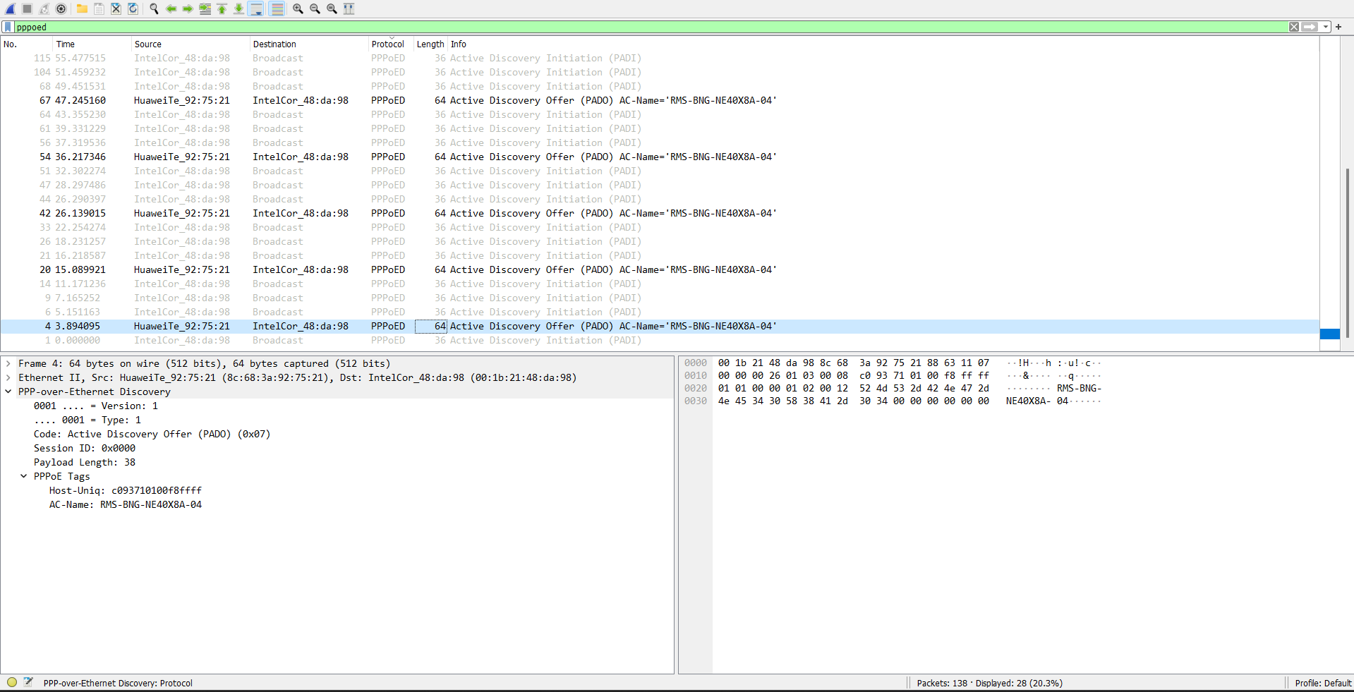

I tried having the router in bridge mode (basically adding another WAN interface and having it in bridge mode) and removed the PPPoE WAN interface. Changed WAN type in pfsense to PPPoE and added my line details, but it times out trying to connect to PPPoE and keep retrying.
I did a pcap and opened it in wireshark, it keeps going like this, 3 PADI 1 PADO received and the difference between the first PADI and first PADO is 10 seconds every single time. So as 9 seconds passed pfsense keeps sending PADIs and rejecting the PADO it received for the first one.
