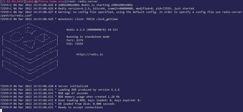

I did run redis-server manually from shell by using command redis-sever then I started ntopng and it stopped after a minute or so.

Spent the last few hours banging my head and still nothing too good but I think it might be an issue with redis possibly. I did run redis-server and then right after I ran service redis onstatus and found that it is saying redis is not running
Next thing that I found was when I do run ntopng I am getting Can’t assign requested address and when I try redis-cli ping I am getting same error message. Which again telling me possibly something wrong with redis
I got it to work temporarily by doing the following
1- Run redis-server with protected mode off
2- I had another shell going and gave it my Lan Address using the redis-server port
ntopng -r 10.10.10.1:6379
3- Loading web on port 3000
