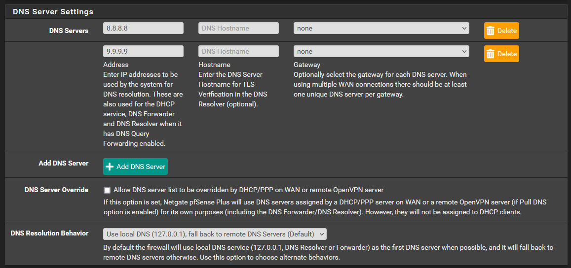

i have a netgate 3100 with a simple setup, no special, a vpn and one Vlan and some port forwarding. it is on release 22,5 right now (i know i will update), but this problem have been with several releases in the past.
with some weeks in between the DNS just stops working as it should. we do notice it when we can´t access some webpages, ping is working. I go in to the netgate, change DNS server and it is back up again. Then it works for some weeks again until next time.
i have tested several different DNS servers like google, quad 9, 1.1.1.1 and so on. no difference.
The logs does not show me anything i can clearly relate to the problem.
anyone have a suggestion?

What is the setup for dns resolvers
