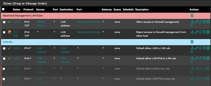

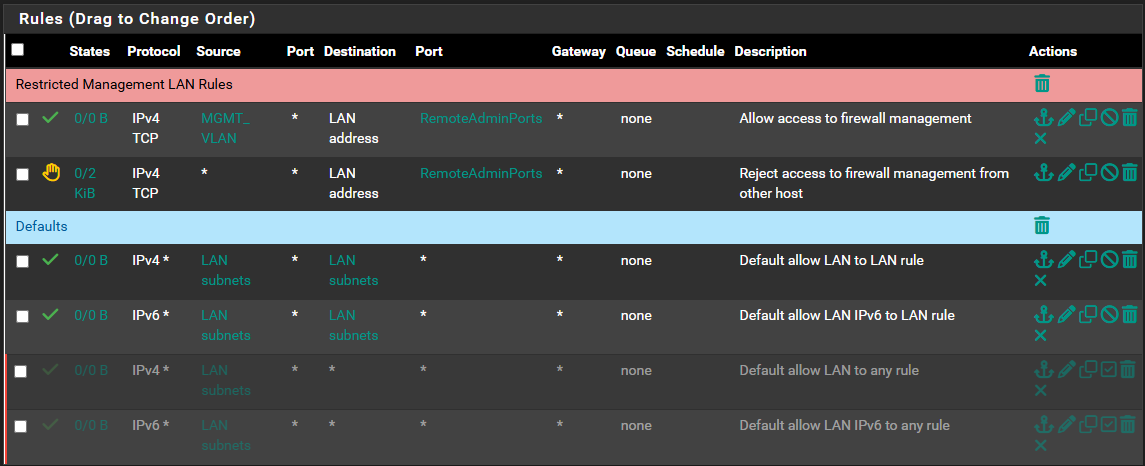

I have managed to shift my Switch, AC and AP’s to the MGMT_VLAN thanks to the guide and can access webmgmt gui from a mgmt_vlan only access port on my switch.
However, I am still slightly unsure about the last rule they have shared where they pass 10.0.0.0/8 to any.
Is this a variation of the current default allow on a fresh install? Where there are 2 rules to pass IPv4 and IPv6 from LAN subnets to any?
In that case is 10.0.0.0/8 equivalent to LAN subnets in their example? Or is that some other network being referenced?
I’ve disabled the default LAN rules for future reference below, and replaced with internal only LAN to LAN rules for future-idiot-self randomly plugging into empty ports for testing.
Thank you!
Using 10.0.0.0/8 is an example of allowing rules for any networks you have that start with the 10.0.0.0. If you are using another subnet range such as 192.168.0.0/16 then you would that.
Thanks @LTS_Tom will read up more on firewall rules to be sure of what I’m doing.
