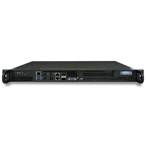

Netgate hardware wise, Tom’s your man.
Thanks Tom and mikeys. Tom’s rec is relatively expensive for home use. I am not familiar with network equipment when it comes to choosing servers. Energy cost is not a big deal for me.
If I let go the 10gb routing capability, what would be my choices for a rackmountable/shelf(able) option up to $500?
In netgate territory the 4100 may fit your budget. Not sure if it will do ntopng and route over 1gbe, though the LAN ports can do 2.5
Maybe some netgate users could clarify?
