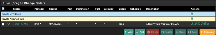

Rules for this subnet are extremely simple:
