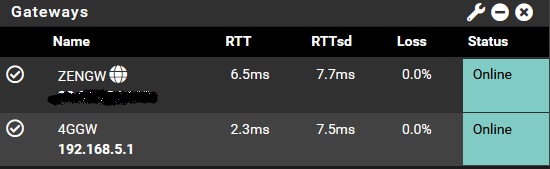

I have exactly this configuration here. It fails over to 4G if my wired internet loses connectivity & automatically fails back when the connection returns. It’s so seamless that I don’t even get a pause when streaming.

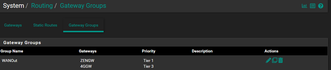

This is how I have things configured:
Dual GW
Setting the gateway monitoring & tiers in the gateway group is key. On the wired connection I monitor 8.8.4.4 and on the 4G connection I tick “Disable Gateway Monitoring Action” so the 4G gateway is considered to be always up.
