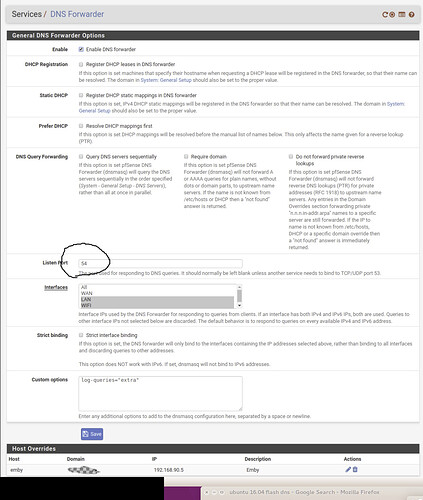

So far I am out of luck. Here are my settings:
I had to use port 54 as 53 suspected to be used by pfBNG or DNS Resolver. Is it OK ?
I do force all clients to use pfSense port 53 for DSN calls as in
Anything jumps at you ?
Thanks for helping !
PS: I suspect my set up of ports 53 and 54 is wrong …

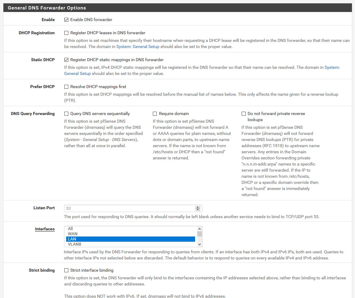

These are my settings. I cannot remember if I ever changed something from default.
I do not have a DNS firewall rule.
Still no love ![]()
Maybe somebody has some ideas ?
What’s interesting that I do see my emby.mydomain.lan name registered in /etc/hosts
Do you have DNS Resolver also listening on 53?
FYI
I do not have the DNS Resolver activated.
When I look at the menu options it is almost the same as the DNS forwarder.
I have no clue what the difference between the forwarder and resolver is.
It is more that 3 years ago that I set this (private) box up and do not remember why I choose to use the DNS forwarder instead of the DNS Resolver.
Just FYI same behavior can be done via DSN Resolver/Host Overrides and add a host values there
