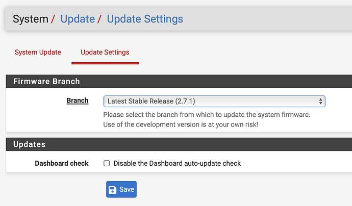

Make sure you update the selected branch
@elvisimprsntr

I’ve had this same problem on one of my systems. My version train is set to latest stable release and had been bugging me to update for a while. When I finally had time to do that, I logged into the dashboard and it now says there is no 2.7.1 update. I figured there’s some glitch that will get sorted next time I check in.
EDIT: I just took a look at that system and it looks like it’s still stuck.
@tvcvt
In my case, I first had to switch to V 2.7.1 under the “update settings” tab before I could carry out the update to 2.7.1
This irritated me, as my PfSense had never indicated an update in the dashboard. Fortunately, the update has now been installed without any errors.

In my case, I switched to 2.7.1 under update settings tab but it kept showing 2.7.0 and status Up to date, but now it apppears to have a new option 2.7.2 latest stable release. I’ll wait until I found out more about this.
