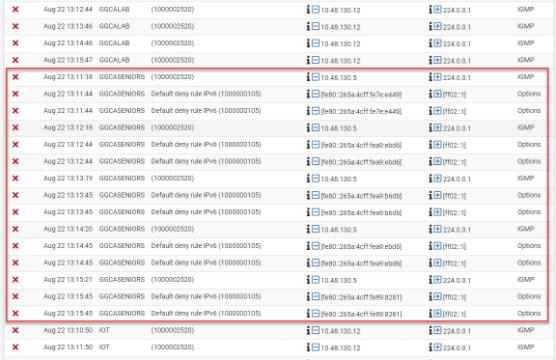

Whats the best steps for troubleshooting? This is what I see for this network under system logs / firewall…

I can ping google.com or anydomain.com from the other networks without an issue, except when Im connected to the network GGCA-Seniors
