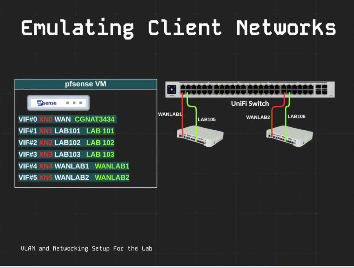

Evening, where is your 2019 video for installing pfSense on XCP-ng? I need see how you did the WAN and LAN NICs. Is the LAN NIC a isolated network and can the LAN access the internet via WAN, because this is my goal.
Also for testing from my main network (simulated internet) of connecting to the web server inside the isolated network, among other security testing using Kali OS.
Thanks!.
In XCP-ng I would use a dedicated network just for the WAN of pfsense (or any other firewalls) for simulated internet. I prefer to use the CGNAT for that but make sure you don’t have anything you are testing that overlaps with that range such as your own ISP or some overlay VPN. I avoid that issue by having a more limited scoped range.
For LAN I did the same, just created a dedicated network.

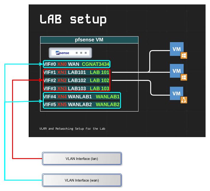

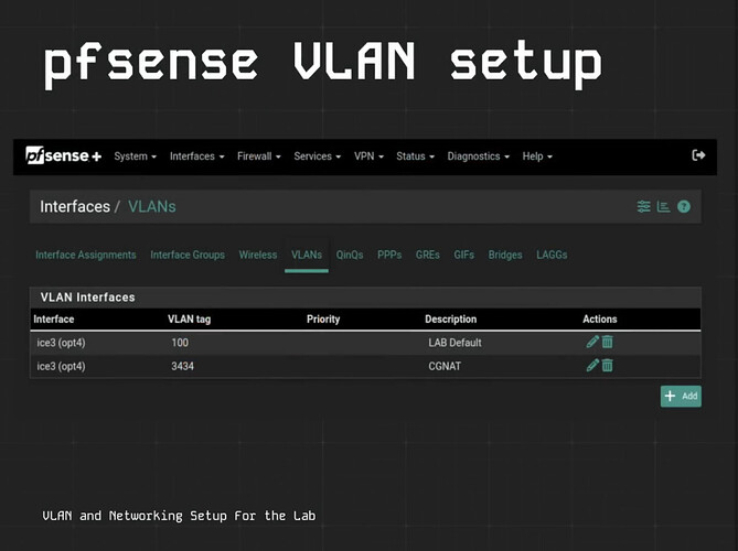

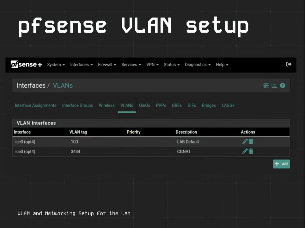

Are all the VLANs created on VLAN Interface (lan) or as:
because I’m assuming the WAN(CGNAT3434, LAB1&2) are used to connect to the internet or outside the LAN somewhere being that the 3 VMs are connected to the LAN?
Also, are the ports connected to the pfSense Consoles set as All/Default(1) or VLAN ID?
Each port is set to only the VLAN that I want on that port and then I choose the “Block All” so other VLANs are not available.

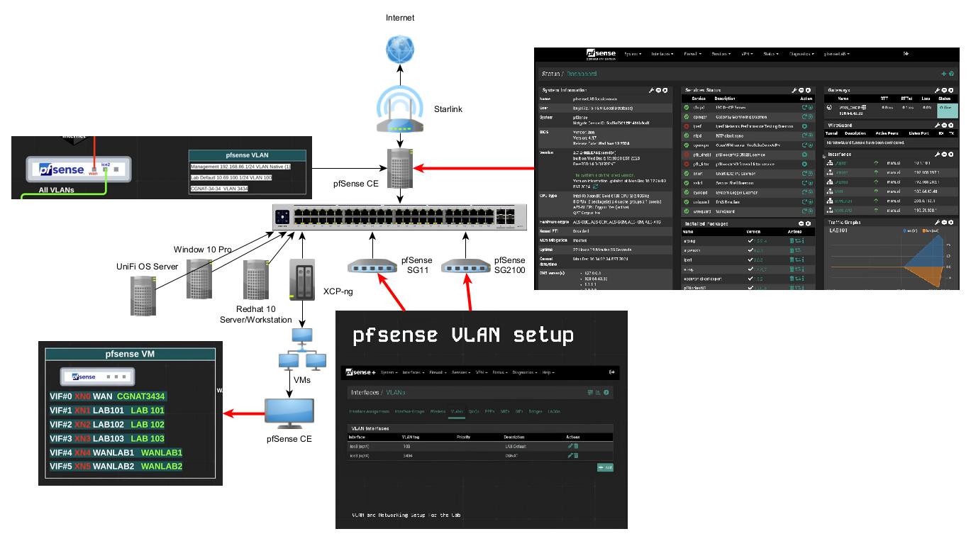

Clarification for the WAN on the Console’s IP Range source - I know any VLAN ID from the pfSense VM will do, but for clarity: is the pfSense VM’s WAN(CGNAT3434, WANLAB1&2) VLAN Interfaces assigned to (wan) has diagram here? I assuming the (lan)…

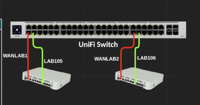

The LAB 101, LAB 102… & WANLAB1, WANLAB2… etc are all LAN on the upstream pfsense.

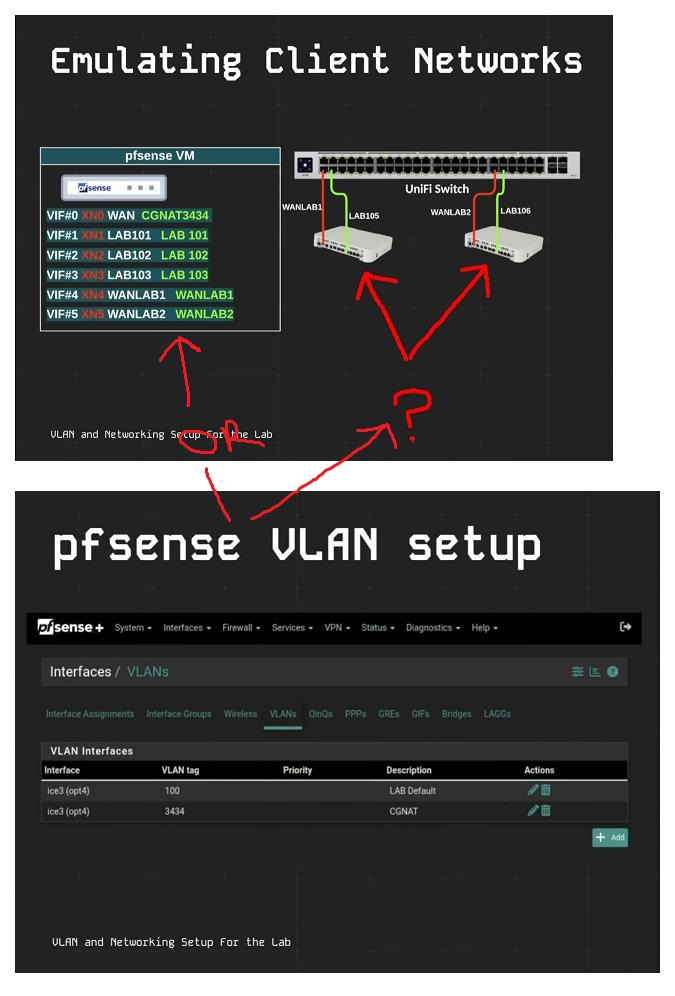

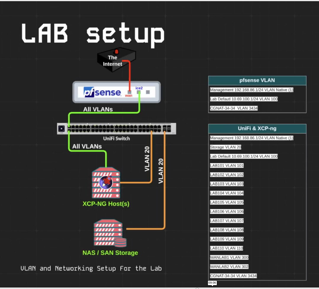

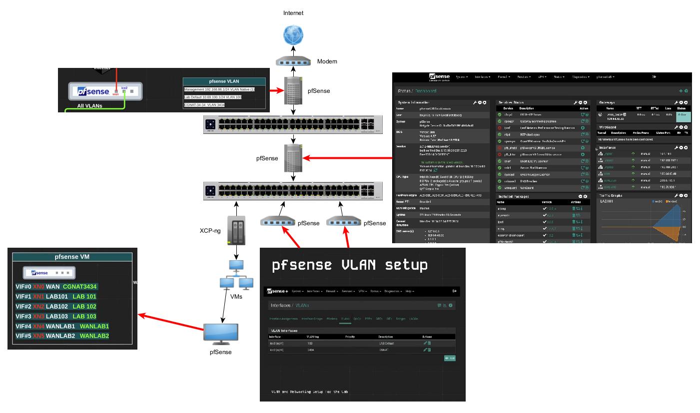

Is this the upstream somewhat of how your Network is setup to get the same Lab results, rather if the two top upstream pfSense are Consoles or not (hand build)?

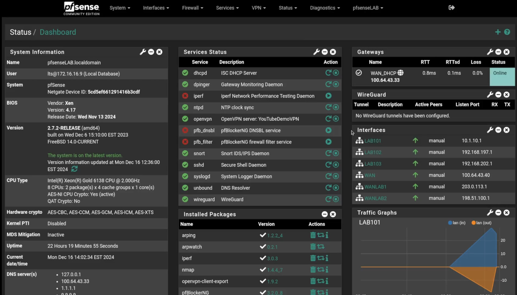

That numbers are too small to read but that looks similar to the video I did. I need to make a new version as I have UniFi at the head end of my lab now and pfsense downstream.
Yes, all the screen shots came from the video you supplied me above in the post: How to Build A Powerful Networking Learning Lab
Here are the photos used for the diagram from left to right:
Please inform me when you complete it.
