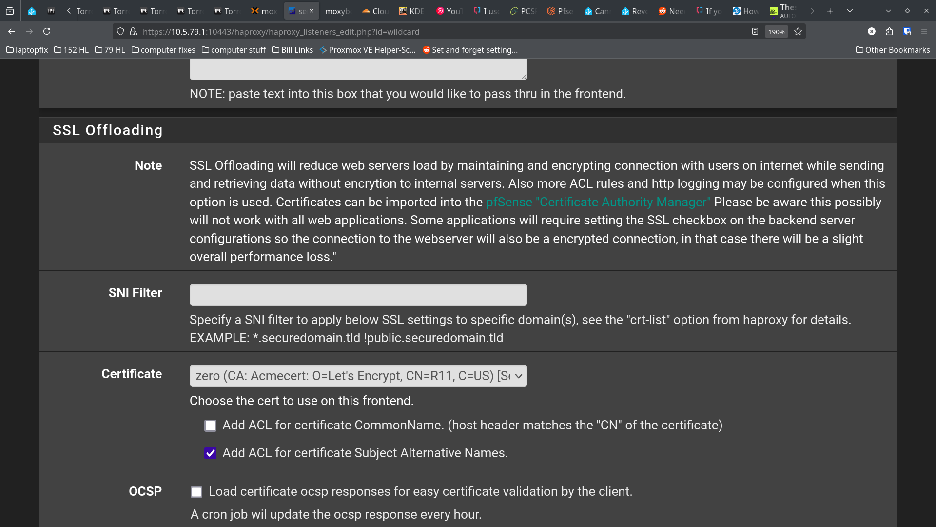

First, make sure the correct certificate is being served by HAProxy, and that the certificate actually contains the correct server name. If you’re using a wildcard certificate, keep in mind that Let’s Encrypt only issues wildcard certificates for one level — for example, *.yourdomain.tld works for sub.yourdomain.tld, but not for sub.sub.yourdomain.tld.

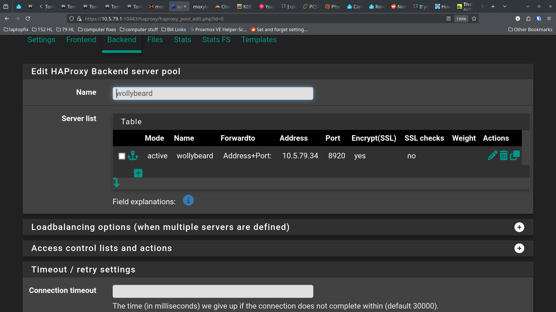

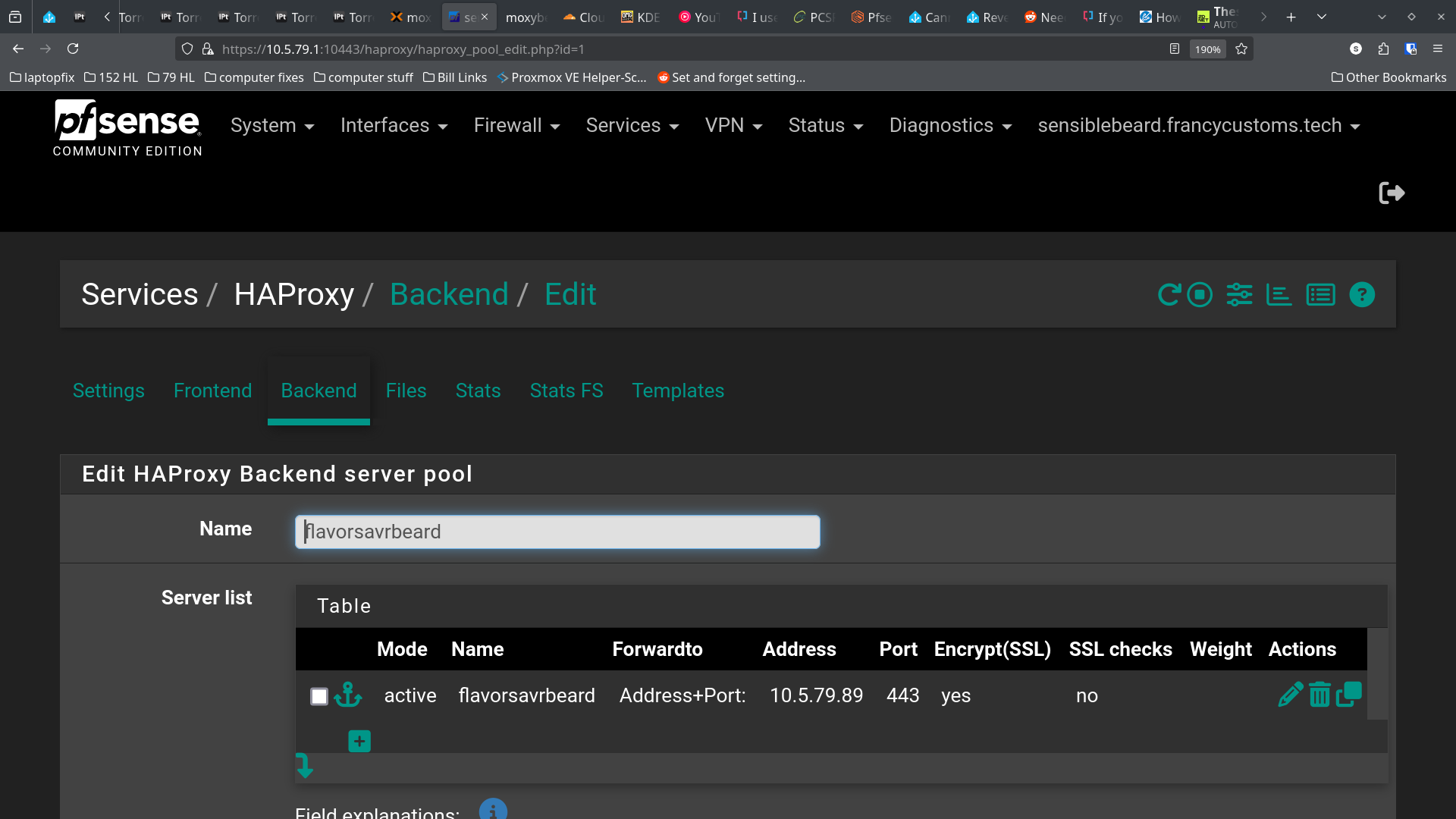

Also, if you’re using a self-signed certificate on the backend server, make sure “Encrypt (SSL)” is set to yes, and “SSL checks” to no in your HAProxy backend settings.

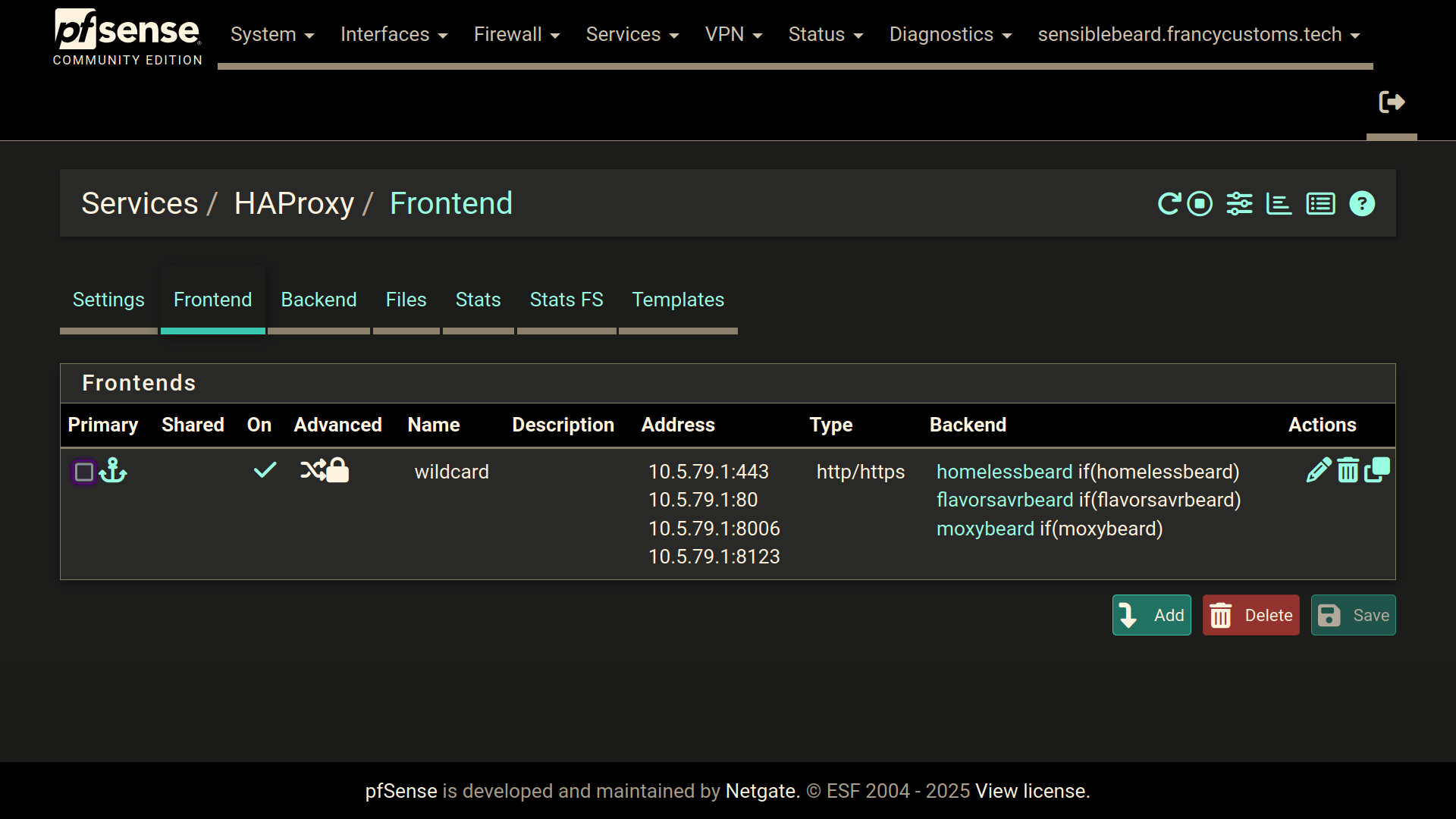

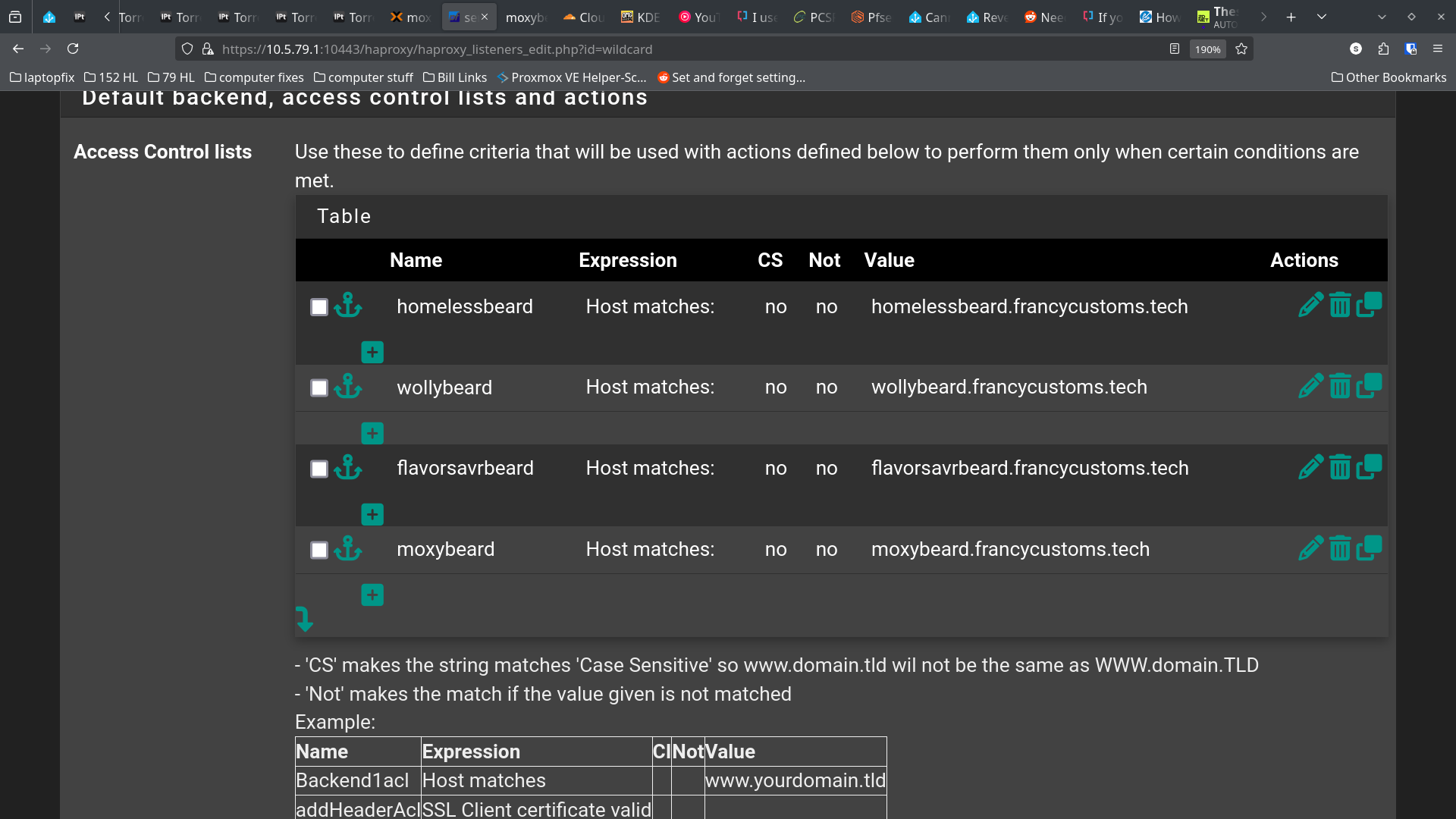

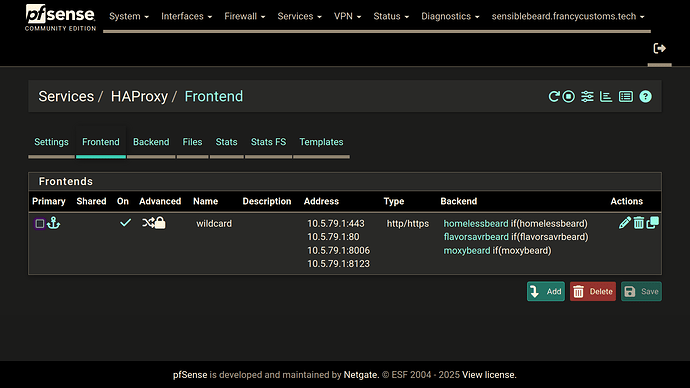

Hello so sorry for the delayed response I can only dedicate time to this late nights when the family is sleeping and I still have energy left to think. I still have not gotten very far in this endeavor. I have a 503 server error every time I try and connect to my home assistant or proxmox server.

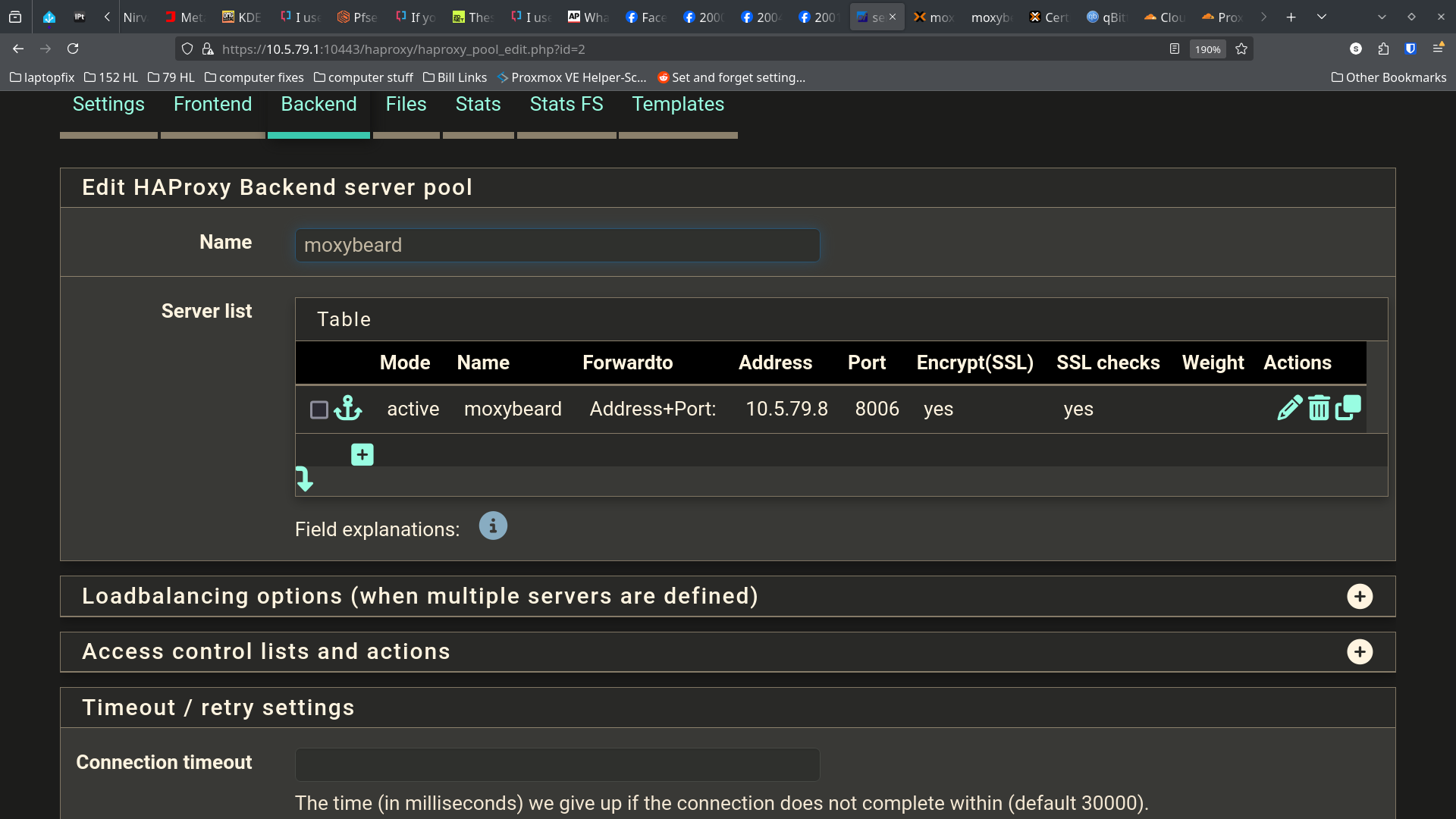

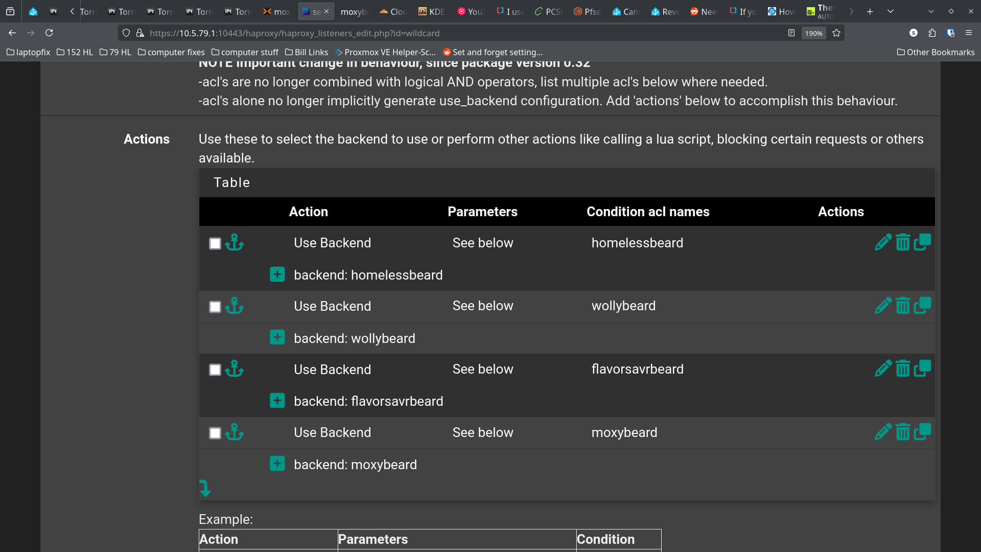

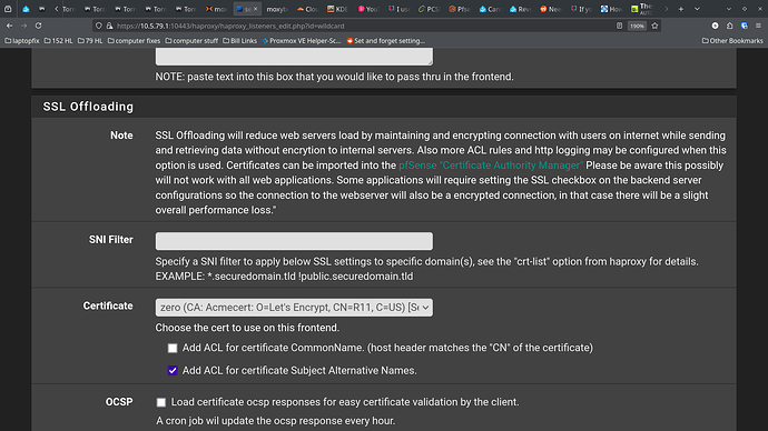

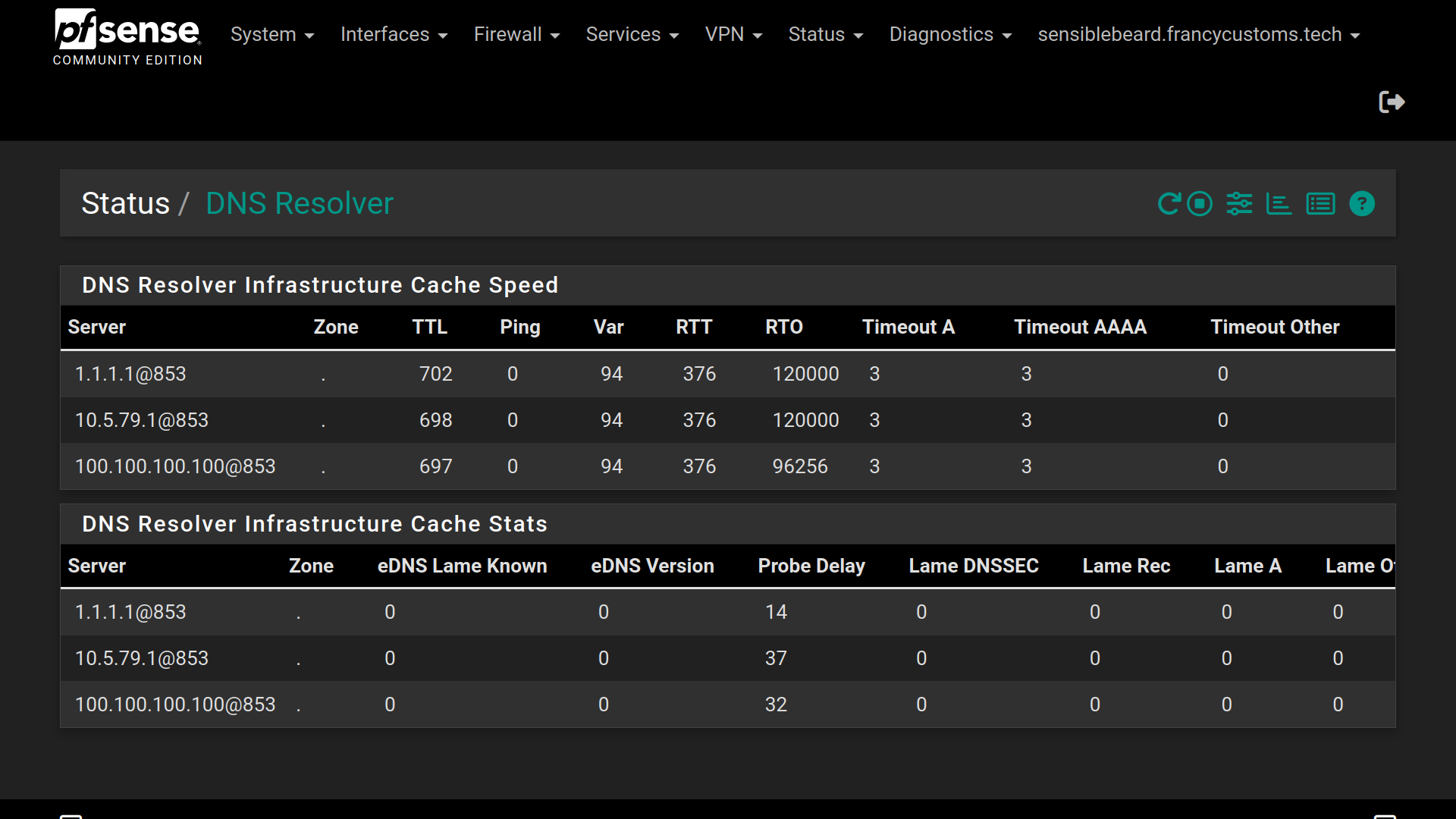

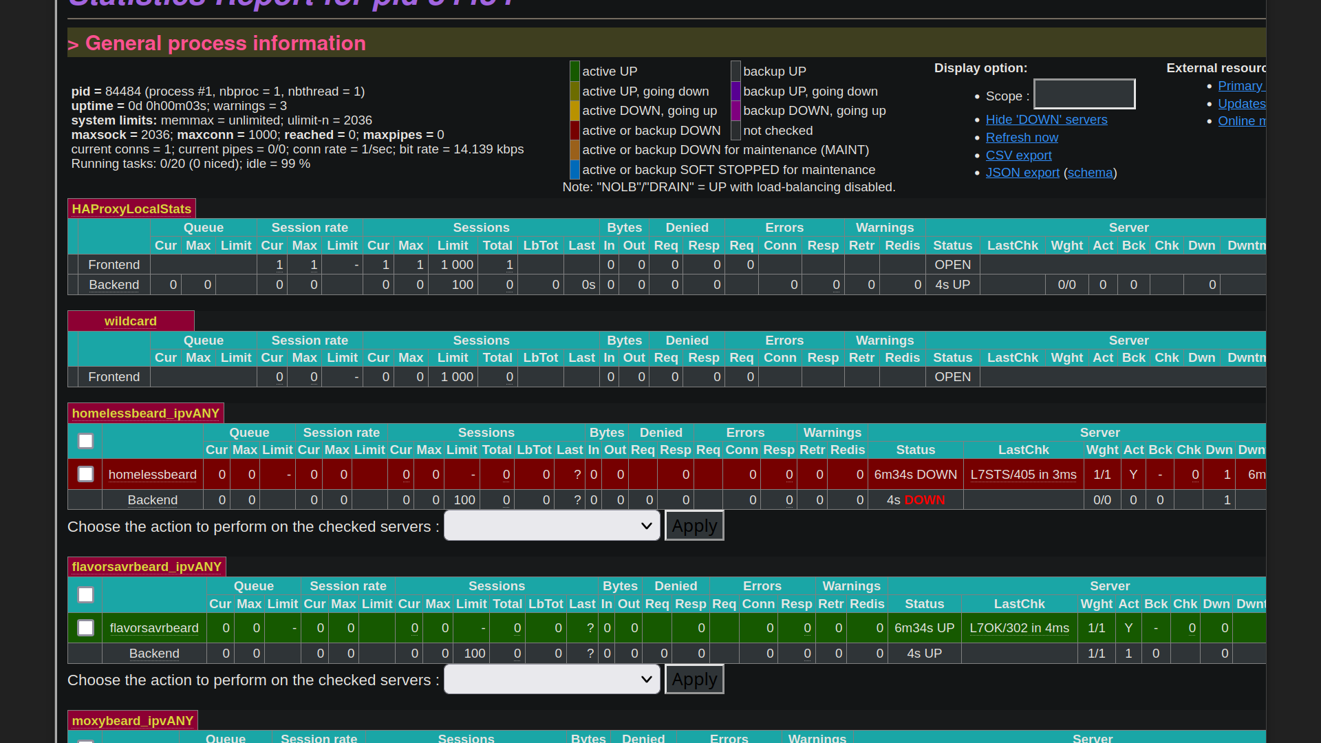

maybe with these screen shots one of ya’ll might be able to help me. I am so close to almost understanding this crap but somehow it still escapes me. Thanks in advance.

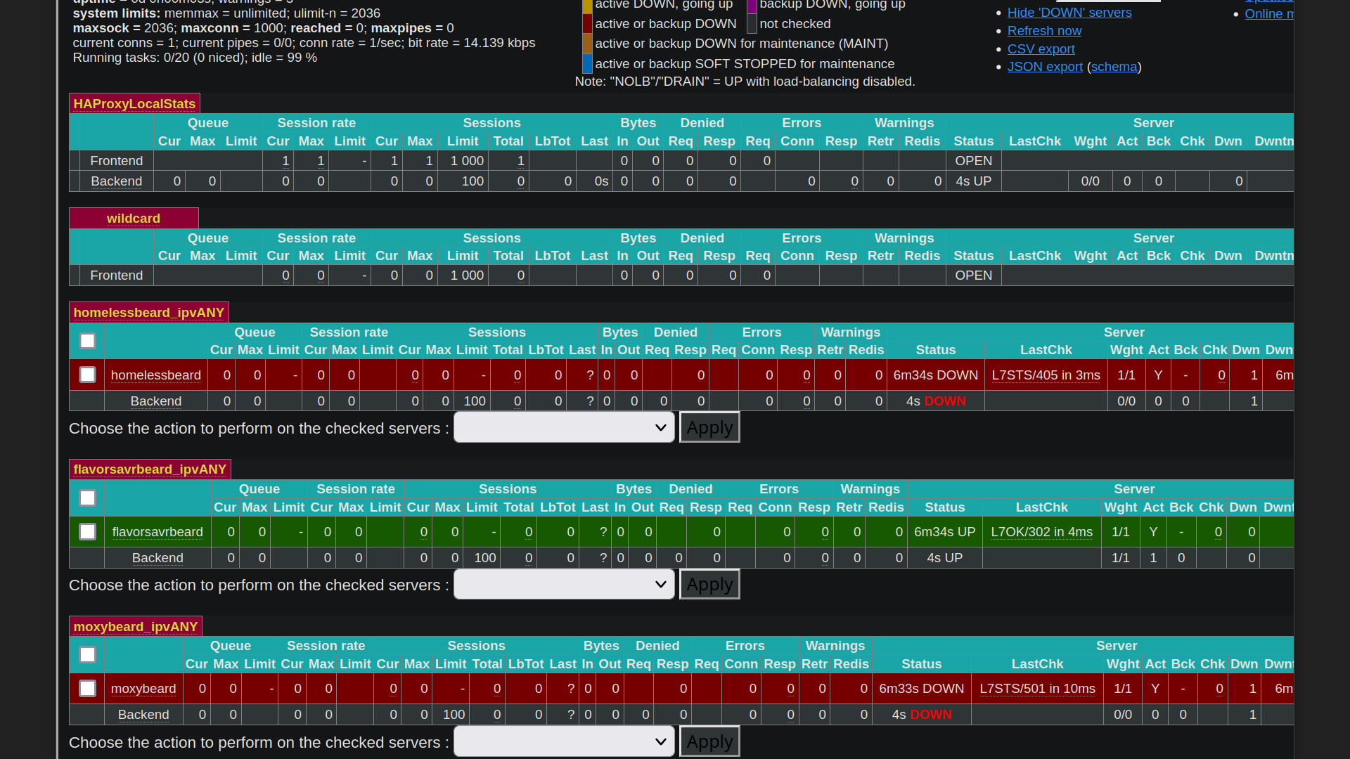

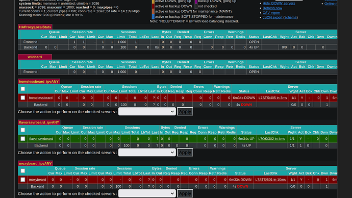

It would be nice to know how your DNS is resolving these addresses (it should be the IP of your HAProxy node) and what the HAProxy stats page says. I had a hard time figuring out which service matches up to which hostname, but one thing that jumped out what you should turn off SSL checks on your Proxmox backend. Even if you have a publicly issued certificate on that host, it almost certainly isn’t valid for that IP address, so that should cause HAProxy to throw an error for that backend.
That was the only big, obvious issue I saw in glancing at the screenshots. I suspect @bb77 is right in pointing to DNS. That’s a big problem area when people first start messing with reverse proxies.
There are a few things here.
  • First, note the problems in the HAProxy stats page. That’s the issue with having ssl check set to ‘yes’ when the backend is using a self-signed or invalid cert.
  • Also, your front end probably shouldn’t have all of those ports listed. A more typical arrangement, which you’ll see in Tom’s videos, is to have a front end listening in port 443, which directs traffic to your backends. It’s often a good idea to have a second front end listening on port 80 that redirects everything to port 443.

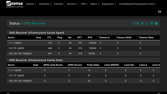

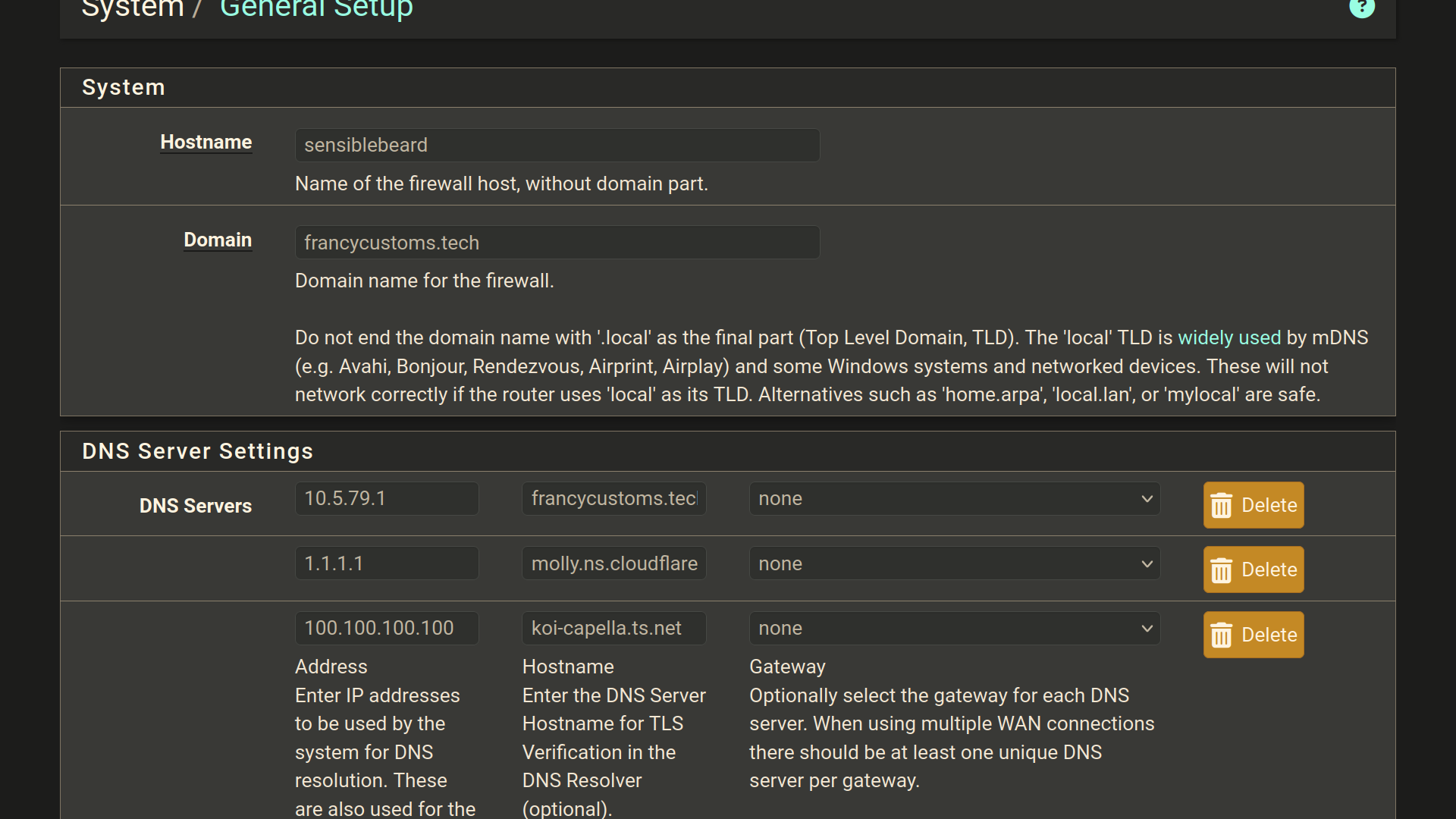

  • The DNS also has an issue. The screen shot you shared shows the DNS servers that your pfSense box is using. In order for your network’s clients to be able to resolve your services, you need to add the hostnames to a DNS record pointing at the HAProxy address. You should go to Services > DNS Resolver and add a Host Override pointing to proxy.your-domain.com and then in the Additional Names section, add each hostname and domain that you wish to have HAProxy handle. The IP address should be whatever address HAProxy is using.
