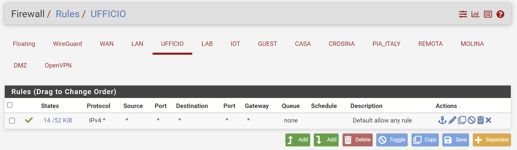

Here is my rules for the two networks.
REMOTA which is the wireguard tunnel
UFFICIO which is my local network
