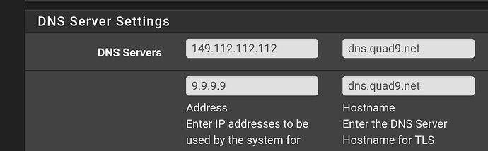

I use encryption too. The only difference is, i use Quad9 instead of CF. These are my DNS resolver settings.
These are my settings in System / General setup.

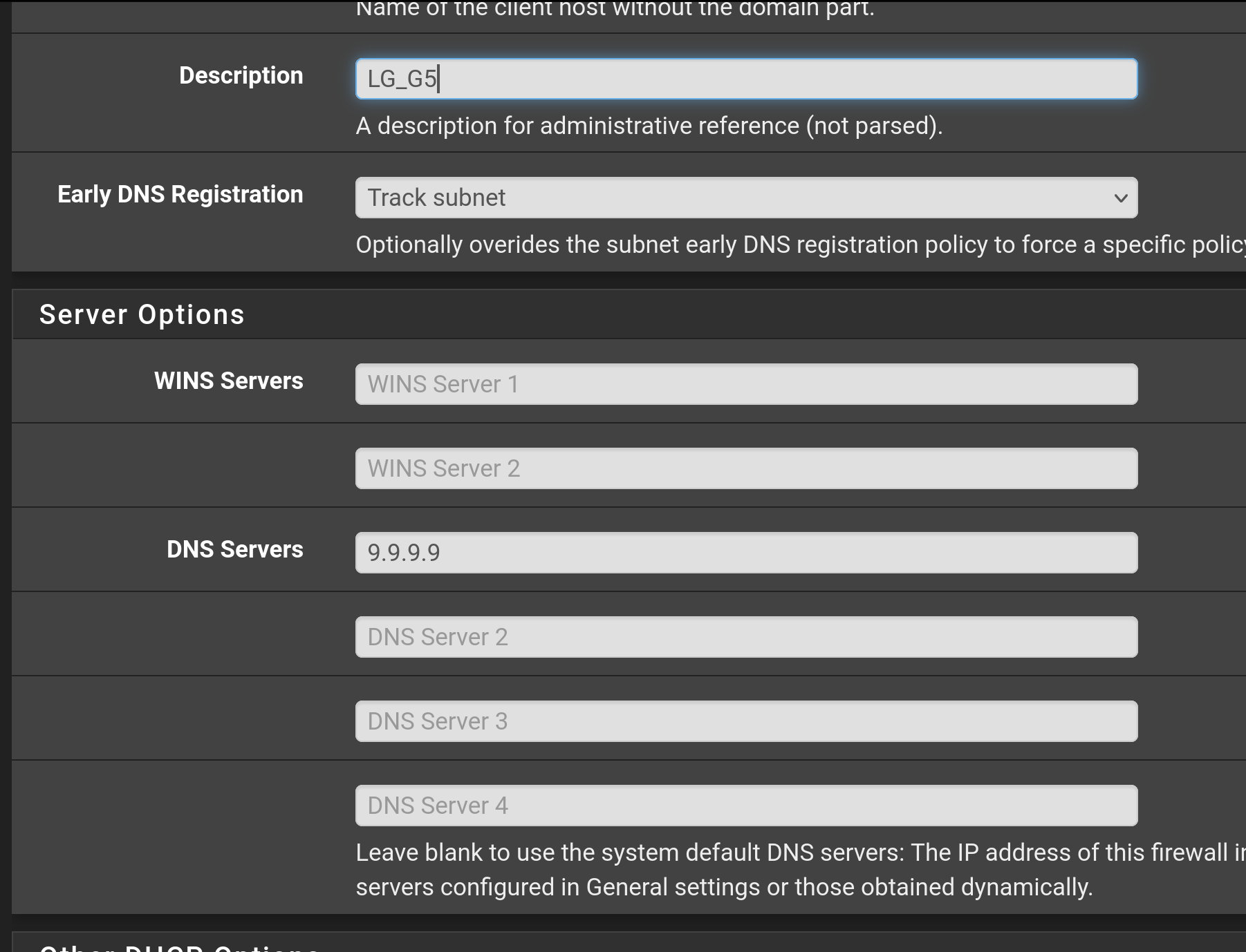

And this is one of my TVs connected over wifi and its static mapping setting under Services / DHCP Server.
Clients without static mappings are getting sinkholed by pfblockerng and they use encrypted DNS over TLS. Clients with DNS setting defined in DHCP static mapping are going around pfblockerng and they go unencrypted to Quad9. No issues at all on pfSense CE 2.8.1. I dont have any clients that randomize or spoof their MAC addresses. So check that at your end.

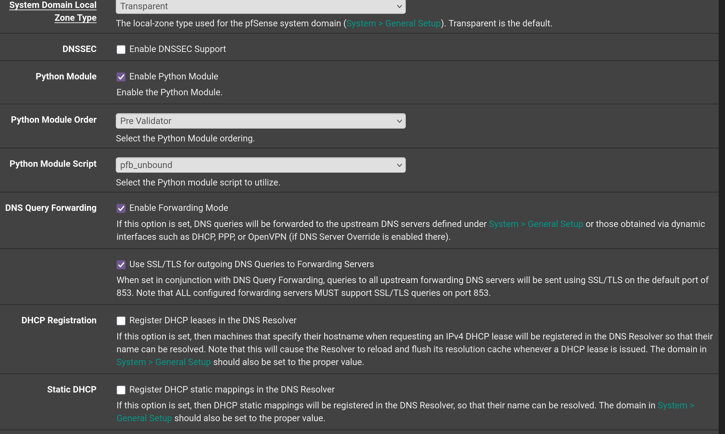

Also- it looks like you’re using unbound and have a script for it there- I don’t use unbound- just pfBlockerNG
No scripts. I just switched pfblocker from unbound to python mode for efficiency because i use dnsbl lists that have more than 3M entries in them.
