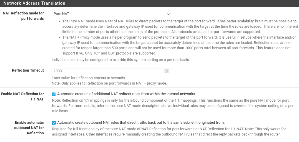

Do you have pure NAT enabled ?
System > Advanced, Firewall & NAT tab
enable NAT reflection: checked
enable auto outbound: checked

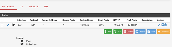

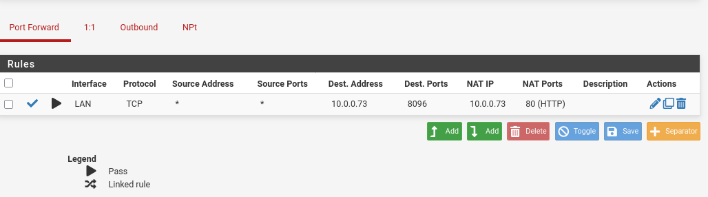

I tried his example, I have a jellyfin server on 10.0.0.73 on port 8096
when I type on my browser http://10.0.0.73:8096 it shows the jellyfin page
created a port forward rule
but when I type on my browser http://10.0.0.73 it does not go to jellyfin
NAT reflection is selected with purer NAT. I also tried the other options. I do not see a checkbox for enable auto outbound though.
I found those settings, thanks. It still didn’t work.

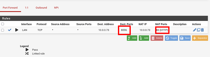

I think using a reverse proxy such as HAProxy would be the easiest solution here. If you are wanting to try it with just NAT, maybe try switching these two around (see red boxes).
That way when you go to http://10.0.0.73, your browser is destined for that address at port 80 (http runs on 80) and would be NAT’d to 10.0.0.73:8096. Right now it appears that your NAT won’t happen as http is destined to hit port 80 and your “destination” is on 8096. Sounds backwards but may do the trick.

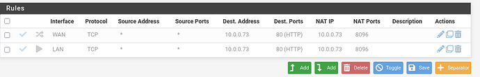

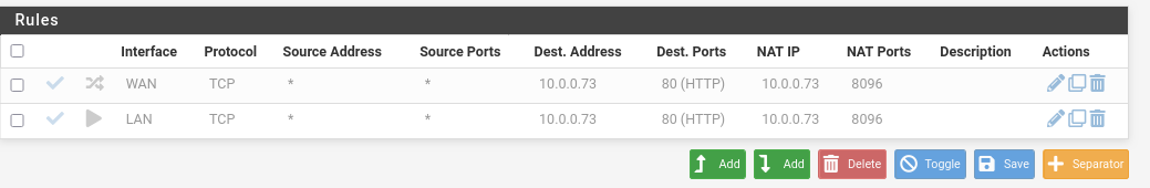

it did not. I made two rules, one for LAN, one for WAN.
enable the LAN, tried it, will not show the jellyfin page.
disabled the LAN rule, enabled the WAN rule, tried again, same.
