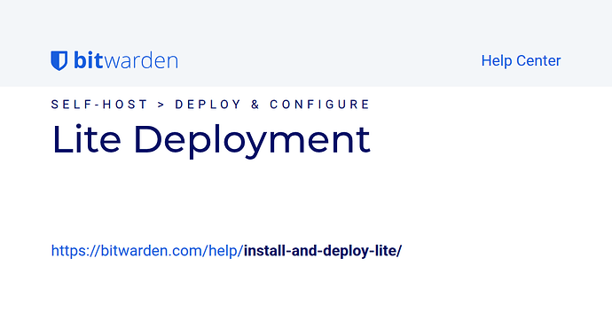

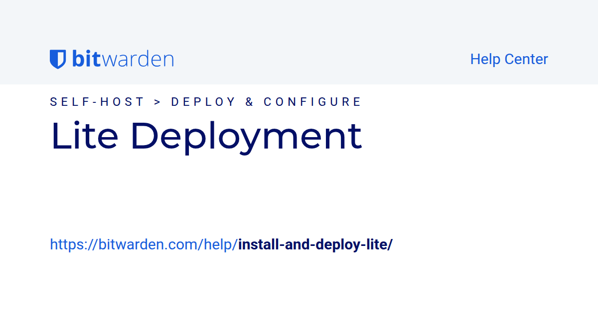

One option you didn’t mention is to look at is Bitwarden itself since you already know and like it (via Vaultwarden). Bitwarden is self-hostable: Self-host Bitwarden | Bitwarden.
Is this a tool for an entire team, or just you? If just you, have you looked at this thing?
I may give one a try so I have a portable password manager, and the FIDO2 might not hurt either. It has decent reviews for the USB A version, pretty poor reviews for the combo C and A version. I think the A version with an A to C cable might be the way I go. Going to think about it a bit more and maybe add to an order.
[edit] there is also Zerokey that might be worth looking into, but again for individuals
I would go with Bitwarden and they now have a lite version

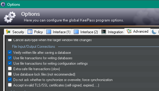

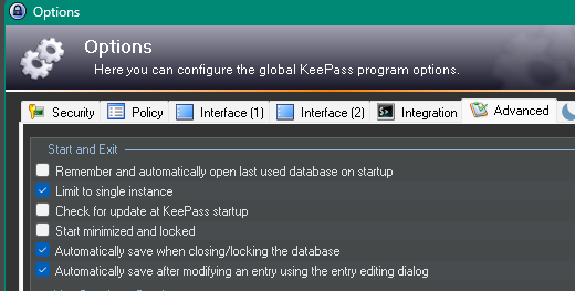

We use KeePass. The full installer (not portable) is used on each client so it gets registered as an installed application and routinely patched by our endpoint management system. We have the database (.kdbx) files on a network share with ACLs protecting the files and personnel control by selective sharing the master password. The way we configure KeePass we’ve never had issues with multiple users accessing and overwriting each other. To make the config consistent across clients, just configure one machine then copy KeePass.config.xml to %appdata%\KeePass which could be handled by logon script. Here are the important options to make it work well for multi-user:

The lite version as well as the normal are free to use only for home not for business.

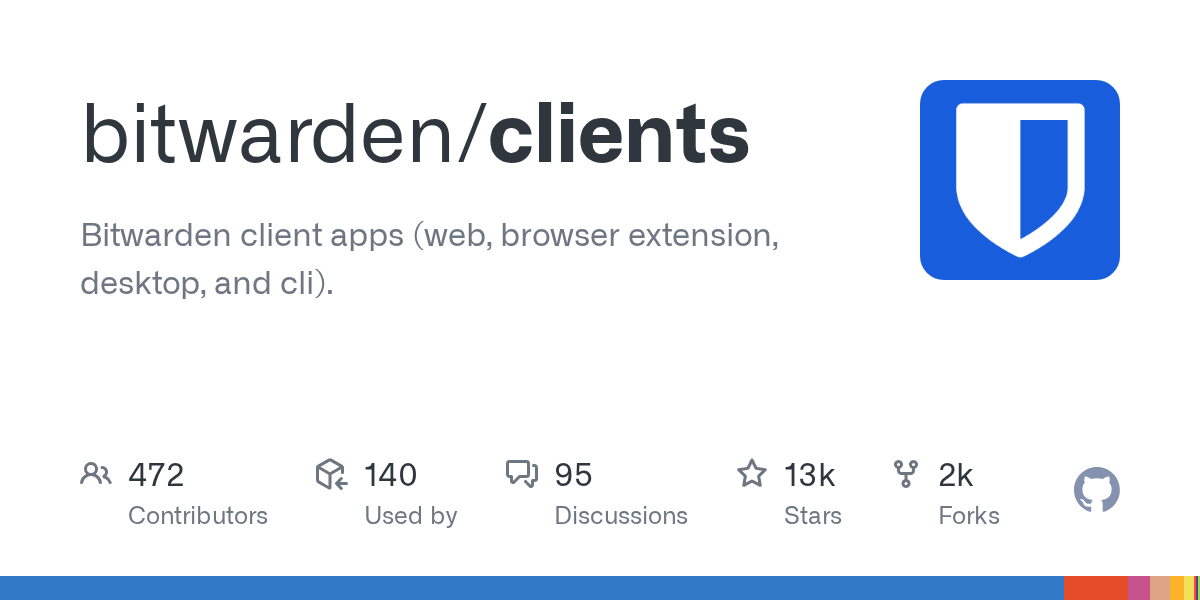

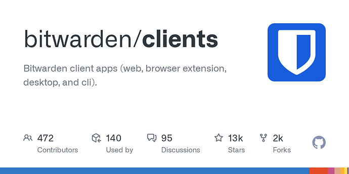

Both vaultwarden and bitwarden clients are gpl3. You are free to use them as you wish. Only paid features require a license.
I have it running in several businesses with no issues.
Nothing wrong with supporting good software with a license though. Programmers have to eat too.
If you are worried about a rug pull it’s easy enough to export to another tool. Bitwarden is battle tested and has a long track record in open source.
My friend, after some research I didn’t find anything preventing the use of Bitwarden for Android or Windows connecting to a Vaultwarden for a corporate environment.
In fact, the free version of Bitwarden can be used in a corporate environment without problems; only the password sharing functionality between people will only work with a paid subscription.
However, the clients are all GPLv3 and free.
