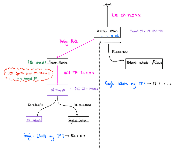

I’m having a problem connecting from the internal network of my ISP’s combo router/modem to my OpenVPN server hosted on a virtualized pfSense via UDP only. I can reach, and connect to my OpenVPN server from any external network, as well as all networks over TCP.
My setup is as follows: I have my ISP’s Actiontech T3200M combo router/modem with port 1 bridged to a Proxmox machine with a pfSense VM. Proxmox itself does not have an internet connection, but the pfSense firewall gets a WAN IP, different from that of the T3200M’s WAN IP:
I haven’t found much info online about my problem, but I think there’s some sort of NAT issue going on. A packet capture on pfSense shows data going from the client device → ISP modem → ISP ONT → back into the pfSense firewall (and vice versa)
