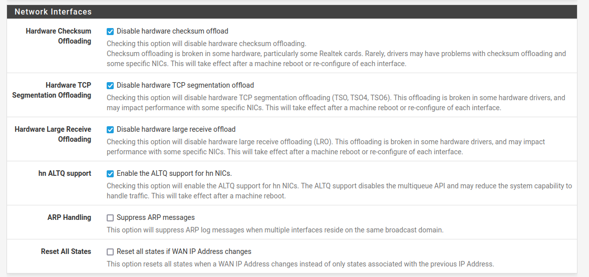

Just for completeness, I’ve been having issues with both 2.5.2 and 23.05 for my VPN connections. To the point where I have lost sight of the changes I have made to my base config.
However, I think I have moved from my PPPoE to Fiber connection and identified the missing step:
On my PPPoE build the Hardware Checksum Offloading was unchecked, now checked I can set UDP on my VPN connections to get max speed. If I uncheck and set TCP on the VPN connection I get close to max speed.
This might help someone else who makes the same change. This works perfectly for 2.5.2 I have yet to confirm this for 23.05 but I’m guessing it will work.
