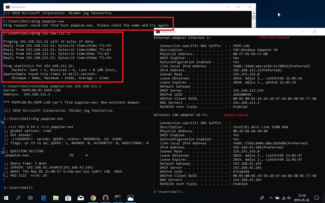

Connected via OpenVPN (I used my mobile internet for the test, but i got a same result whit the other internet). I can’t reach the NAS just only IP:

Adam,
Both the Dig and NSLookup didn’t give you a valid “answer” or record. Dig should give you something like this:
;; ANSWER SECTION:
COMPUTERNAME	3600	IN	A	192.168.11X.X
I notice on the nslookup the name server fully resolved itself from you using the IP 192.168.111.1 it responded back with a named response of PAPPLAN-R1.PAPP.LAN
I am not expert at this, but whenever my DNS server wasn’t communicating properly I never got to it spit back name, just the IP
Are you sure an A record exists on the server to answer you back for papplan-nas 192.168.111.1
I don’t know how much this will prove…Im just running through troubleshooting steps in my head.

Hi Shane,
I got the following result:
See to me you just don’t have any A record present for local devices. They don’t get there by magic, you have to create the record (or have something setup/enabled to allow clients to register their hostname and IP).
What is the DNS server?
PFSense?
