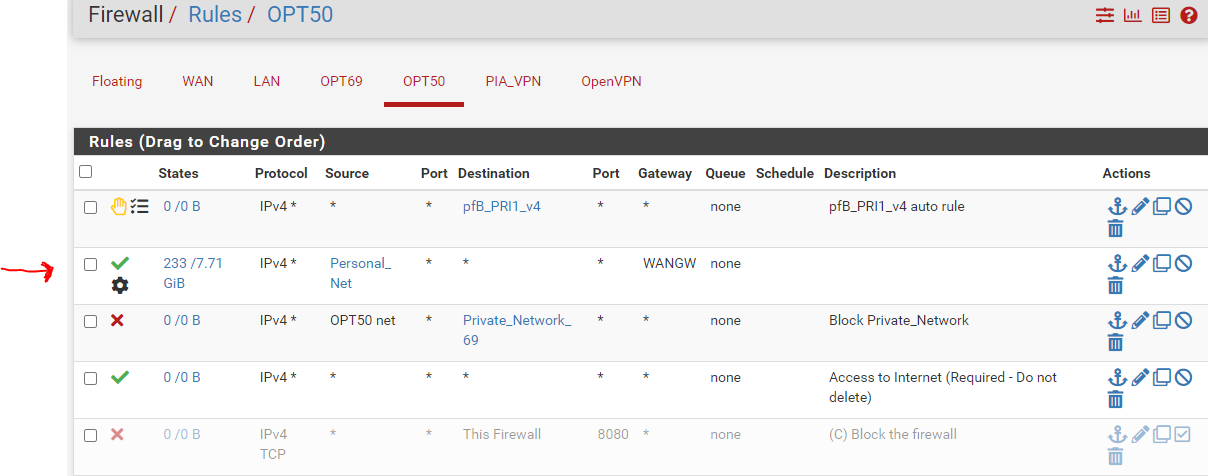

I have setup the pfsense based on Setting up PIA VPN on pfSense for your whole network and Configuring Selective Routing - YouTube video,
and I have added ip base filtering, for example 192.168.50.5 goes through default dns instead of VPN (PIA), I can see the external IP correctly with IPChicken, however, somehow when I trace or ping, results are going through VPN not default gateway? How do I fix that or trouble shoot that?
If the external IP address is showing as the VPN IP address then it is working.
Sorry maybe I didn’t explain it correctly.
I got two PC’s one is 192.168.50.5 and 192.168.5.15, idea is one to bypass vpn for 192.168.50.15.
Within the rules, I have put a rule to bypass VPN
My dns is 192.168.1.256
So when I visit the ipchicken via 192.168.50.5, I can see its use vpn IP address, which is good.
And when I visit ipchicken via 192.168.50.15, I can see it use ISP assigned IP, that is also correct.
However, if I ping or trace google.com from either 192.168.50.15, traffic still goes via vpn with a slow ping time (around 300ms). should it be bypass VPN and get a better ping time?
Where If I turn off the OPENVPN, then I get good ping time from both boxes around 5ms. This doesn’t make sense. Can someone pls help.
