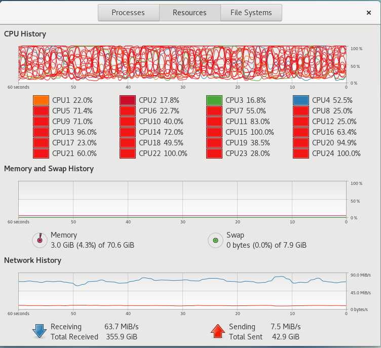

I did a bigger load test on the local network some time ago and got some decently solid metrics. Summary is that you need 1 core (or thread for hyper threaded processors) per connection when playing video (my worst case), ram was not really an issue. Network could become an issue, 11 remote workers, all playing video, consumed between 400 and 500mbps on the workstation to server side, the “internet” facing side was up around another 100-120mbps. So dealing with a single gigabit connection to the server starts to become a bottle neck when you get up into 20+ connections. I’d suggest a 10gbe connection to the server. I saw that you need roughly 6-10mbps per connection for your internet bandwidth, again this is worst case where each remote is playing video (constant screen changes). If doing something that is mostly text based, things are significantly different. And even editing video with Media Composer was on the lower end because the video windows are smaller, and things are not constantly changing unless you are playing the timeline out (again smaller window for playback).
Note that this is in megabytes, multiply by 8. Sorry about all the red, I couldn’t b bothered to change colors on the other threads. That was one of my XCP-NG computers that I forced into service for a day, dual 6 cores and 72GB of ram, I think they are x5660 processors from a long time ago, don’t have newer to try and see what kind of performance increase might happen with newer hardware. The remote sessions did work better than the last time I tried a local test, so there may be gains from using the latest processors and extra cores are needed because things jump around a lot, every core hit 100% at one time or another during the 2 hour test. Yes a few of Youtubers got some add revenue from me that day.
I did talk to another person in a college not too far away and he tried Guac as a VM, and then switched to 3 bare metal servers after that testing. I think it’s up to the core/thread count needed for this. He was just going to build a web landing page to direct his students to the correct lab room connection. He said mostly for ArcGIS classes where they need powerful computers that students can’t really afford. Neither of us work at ivy league schools where an extra $2000+ is nothing but drinking money.
