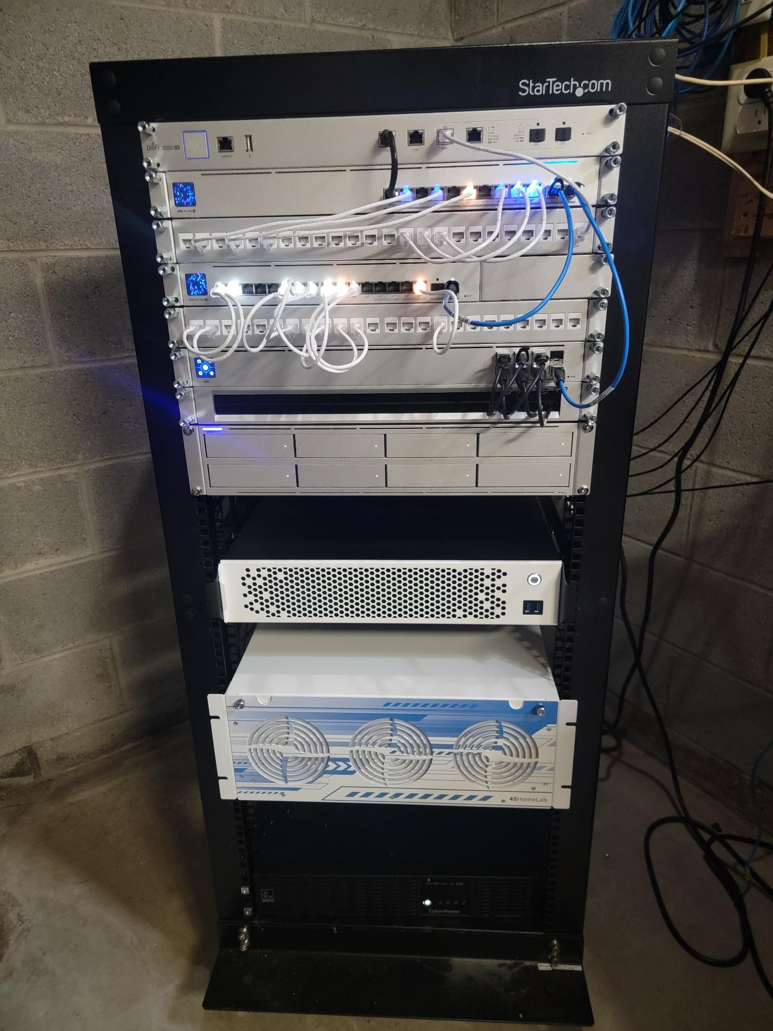

Well, I never got around to messing with this and instead just upgraded to a 45HomeLabs HL15.
Above that is my new Ryzen XCP-NG server that replaced the other 2 old Proliants I was using for that.
