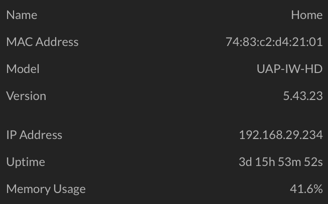

This a screen shot of an AP from my management page. Is your AP getting an IP from the pool?
What model of software is it running?

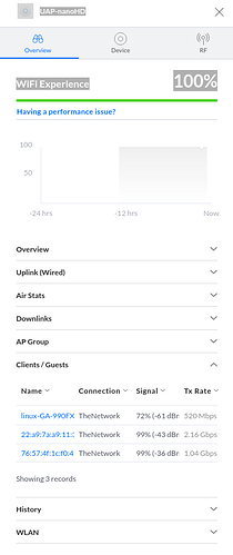

  4. The Cloud Key adopted the AP with no problem. The stais IP is correct for both devices. At least the cloud key says the ap has the correct IP address.
    I have strong sigtnal and the down link and uplink are showing kbps of data passing.
