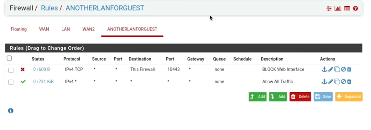

Can you reference a specific time in the video? I see at about min 47 that he has a rule to block TCP port 10443 on the firewall so the admin interface cannot be accessed on the network ANOTHERLANFORGUEST. Then there is an inverse rule that references an alias. That rule says all traffic not going to the alias, which I believe just has the LAN subnet in it, is allowed. The LAN has an allow all rule. To think about this another way, the ANOTHERLANFORGUEST network can get to anywhere but the LAN and the admin TCP port. Port 53 on the ANOTHERLANFORGUEST is included in that list of places allowed. Make sense? Inverse rules are nice for blocking a bunch of access at once.
We see the simple rules for VLANforGuest
Only admin access to pfSense is blocked (so ping and DNS are still allowed).

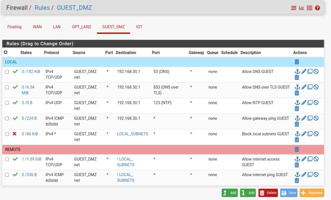

Without the Allow DNS, no ping to google or any internet for that matter.
At your link the screenshot is this with an allow all. Everything IPv4 is allowed everywhere.
At the 47 min time I referenced this screenshot shows an allow all except the alias (which is the LAN). See the exclamation point before the alias? Everything is allowed except getting to the LAN.
Your picture shows all TCP/UDP with a source address on the IOT net is allowed to access the IOT interface port 53. I like to use the actual IP address of the interface but that should work fine. Your picture also has an allow all rule at the end that is mislabeled “allow internet access” when in fact it allows all access to whatever makes it that far down. It looks to me like on you interface you can get to DNS, a couple of IPs and the internet.
The rule to allow the “source = IOT net” is not active on the picture and this is why I can’t access the internet because no device have DNS resolution. If I activate this rule it works.
