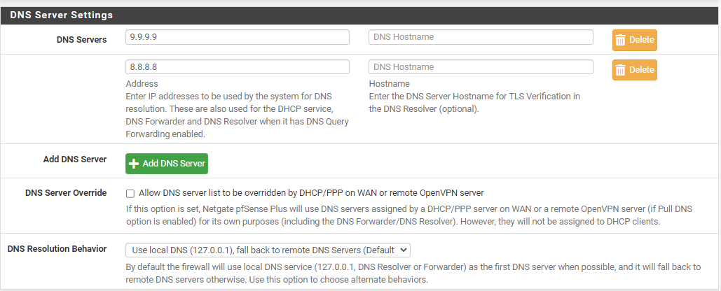

Have you configured DNS servers on PFSense , check your settings as per screenshot - System - General Setup
Untick these options under your wan configuration
Yes, I can access the internet either by wifi or the ISP router. It’s the pfsense router that is having trouble. Those two bottom options have been unchecked already. And below is the DNS settings
