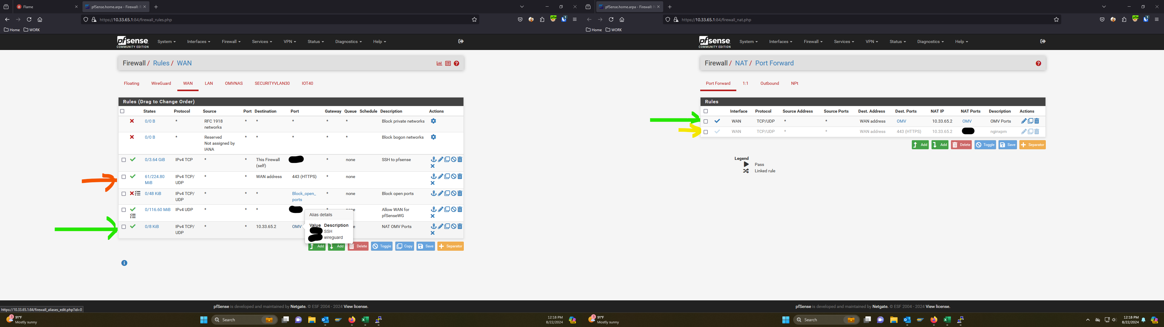

So i have a question about my rules and port forwards.
Should I set a port forward or a rule for NGXPM, I originally tried a port forward( the yellow arrow) and I’m unable to resolve hostnames. Should I have that as a rule instead like I do with HAproxy(the red arrow) and since I’m asking do I need the port forward and the rule (the green arrow) or should I use one or the other?
It would help if I better understood the layout, but if you want access to something behind the pfsense, you need a port forward.
